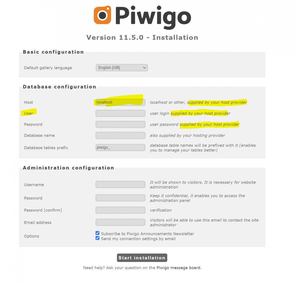

Hi, im new to Truenas in overall. I built my own server a couple of weeks ago. I was debating myself if I should go with Synology, Qnap or simply built my own server. At the end opted on building my own since I can get much more for the price. Installed Scale because of dockers. I though it was going to be an easy thing to work with, but this is no friendly environment at all for people like me with no advance knowledge on linux, permissions... Excuse my ignorance and bold move into move to this system with little knowledge, believing that it was a simple matter of just installing a docker and follow on screen instruction and done. (I come from windows environment as you can see) I never tried Synology or Qnap, but as far as I know their apps are way easier to manage.
Still believe this is the best decision based on hardware, but based on easy of use and customization don't think so. I love the way TrueNas Scale looks and all its potential.
So I installed Piwigo from apps panel TrueCharts and I can not pass the installation page.
Where do I get this info? I been trying to find a tutorial online without any luck.
I know some of you will be quick posting that I need to learn first on how to do certain things on linux and truenas, but that is NOT being helpful at all. If you meant to help me please provide simple info on how to acquire the info I need or how to do certain things. One thing I am not venturing here is running commands in shell and end up breaking Scale. I think we should create simple "how to" steps here for future reference. I am also pretty sure that this can solve similar issues with similar applications.
Thank in Advance!!

Piwigo installation instructions can be found on their website.
As for why truecharts would deploy it sans PHP or a Database, you will need to ask them on their Discord Server.

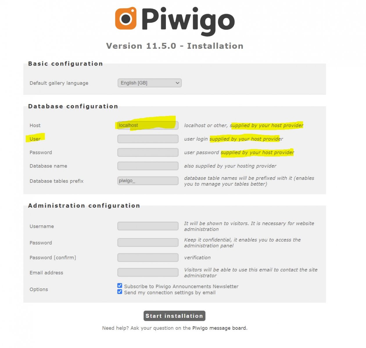

I'm wondering the same thing. I am stuck on the installation window.
Thank in Advance!!

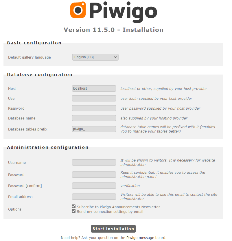

You probably just need to click on another window and come back to it. That said, you still wont be able to use it, as there are no database details, in fact it would seem like there is no database. Piwigo is also 12.2 now, so you are likely better off just installing it somewhere else.

Go to the plugin for this app and click on installation notes, the database details are in there.

I had the same problem. I fixed it by changing the Host from 'localhost' to '127.0.0.1'.
