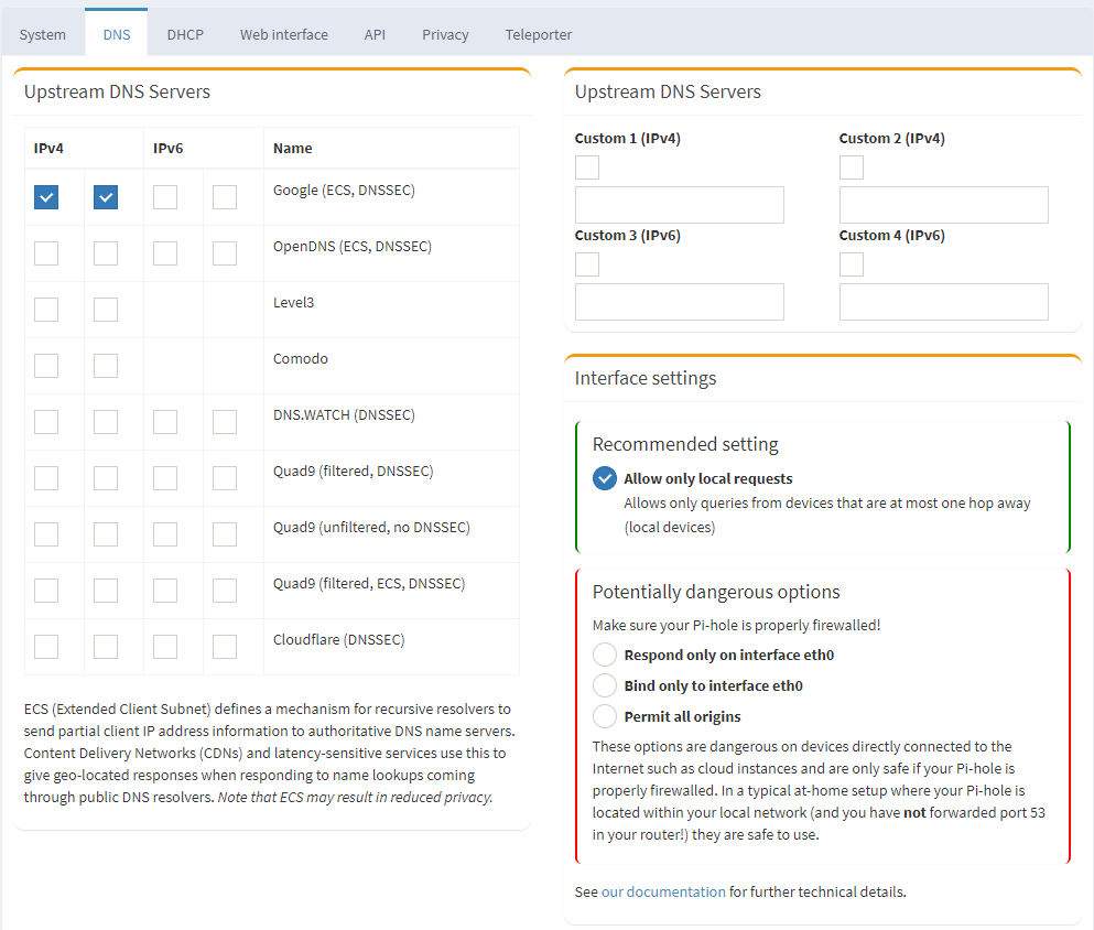

Maybe the DNS settings of Pi-hole can be also relevant:
9,700
Let's see if running without the setting to Allow only local requests helps... Try with Permit all origins as a start... we can think about if that's really a risk or not if we find that it works.

With the options containing interface eth0 other errors are rose (there is no eth0) in pihole since the interface is eno1 (i think).
With the permit all origins options there are no errors but still no connection from the apps not TrueNas
