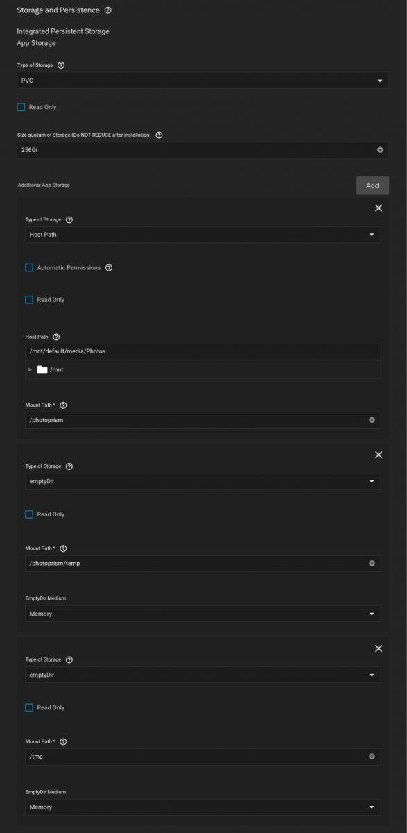

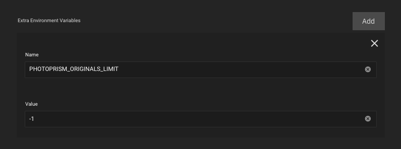

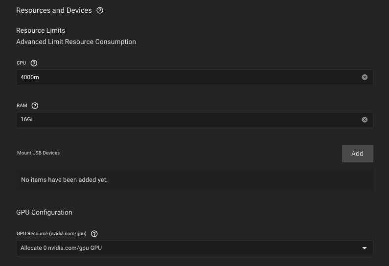

@canosgmk, I only use TrueCharts apps, I don't know the answer for the official apps. First you need to look at the variables set into chart, if the variable is not present there, then you can set it into app UI. As far as I know, you cannot change pre-defined chart variables, not unless they are defined as option in UI. Luckily for us, PHOTOPRISM_ORIGINALS_LIMIT is not pre-defined into chart. Transcoding is not supported into application, since is sponsor based. You can apply the same login for NextCloud, see my related Photoprism app settings, below.
Extra Environment Variables:
Storage and Persistence:
  • All /tmp related directories as ramdisk
Resources and Devices:
  • 16Gi of dynamically allocated RAM
Thank you for the feed back. I went a head and tried the settings you gave me. couldn't verify the variables in Scale. my knowledge of 'shell' is super limited and everything i do says i don't have permission.
anyway, so not the 9min video "uploads" to photoprism directly (photosync still gives me code 413 - request is too large). it says the upload is complete with no error message, but the file never shows up. I allowed over an hour for the video to populate.
any ideas?
