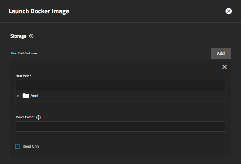

In the "Launch Docker Image" window, you should be able to set up a host path under the Storage menu and map it into the pod.
You'll need to point the Host Path value to an existing dataset, and the Mount Path will be the directory inside your pod, such as /var/MyData

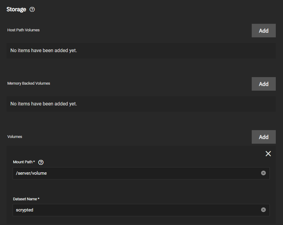

Do you know if its better to use the Host Path Volume or the other one below named Volumes? I found the path to the config data for Scrypted. Just wanted to make sure I use the right storage type?

Volumes are stored under the /ix-applications/docker/volumes or /ix-applications/releases/appname/volumes/ix_volumes path in the pool you assign for holding apps, so if you're using small SSDs for this dataset for speed, then you might not want to put large amounts of data there. A config file or small application database would be fine; I wouldn't put something like a media server's metadata there though (or a temp directory for transcoding large files)
Volumes also currently get pruned if you delete the associated application, but Host Path doesn't.
The Docker documentation has some other comparisons between Volumes and Host Path as well that might be relevant - note that the TrueNAS SCALE implementation might differ slightly though.

Thanks for that clarification, I will use the Host Path Volume instead for this use case, even though the DB will be small, I want it to persist even if the app/container goes away.
