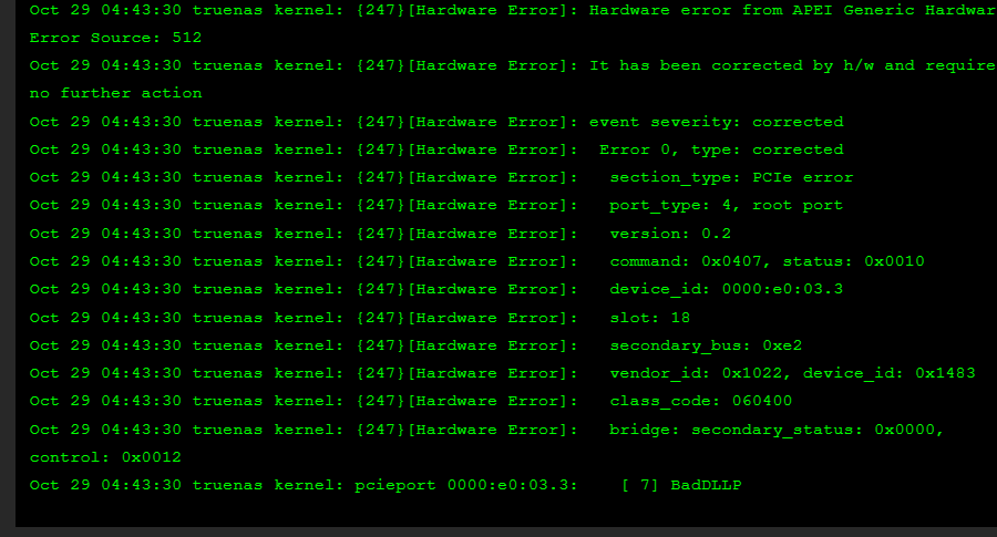

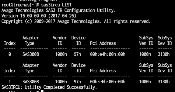

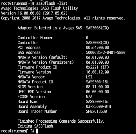

Getting endless PCIE errors on my Rome 2D16-2T with a LSI 9300-16i flashed to IT mode with the latest firmware I could find anywhere- 16.00.12.00 aka the TrueNAS version firmware (patches SATA.)
I think I finally managed to narrow it down to my LSI 9300-16i, and was told updating the firmware would fix it.
Any ideas on where I can find an updated version?
Or is my lsi card simply on it's way out?
This error is also reported on the SEL/IPMI logs, which is why it's an issue in the first place.
I'm pretty certain it's the LSI card.
If it is the card and the firmware is the latest, does anyone have any alternatives?
