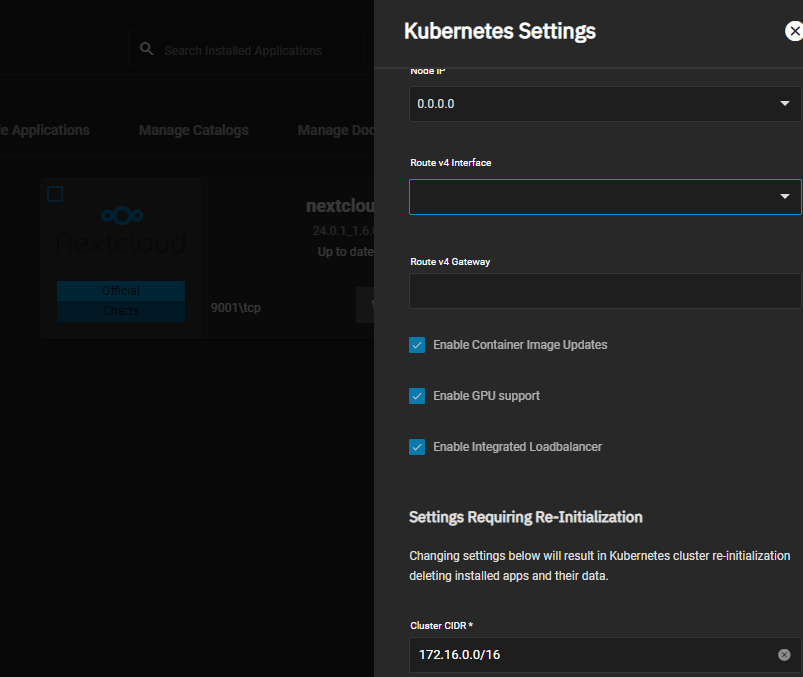

It´s already like that, but dont work for me

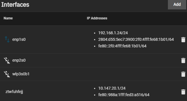

Its my network

I see from your screenshot that you didn't set the other 2 settings... perhaps those are mandatory to make it work... although it might imply that you can't have both unless your router/gateway knows how to go back to the other interface.

Are u saying about network interfaces ??? I´m using only one, the others is a second network port, not in use and other is wireless interface. How disable this ?

I think I solved it... partially.
Interface was in DHCP, I put it as static, so in the advanced option of the apps tab, in the part of Kubernetes in Node IP it started to show the other IPs besides "0.0.0.0", I selected the zerotier interface IP, then I edited the app oficial nextcloud and in Nextcloud Host I also put the zerotier IP and it started to work.
But now only by the zerotier IP, no longer by the IP of the physical interface. I want to make it work in both, but what I needed most is already solved, just need to get both now.
