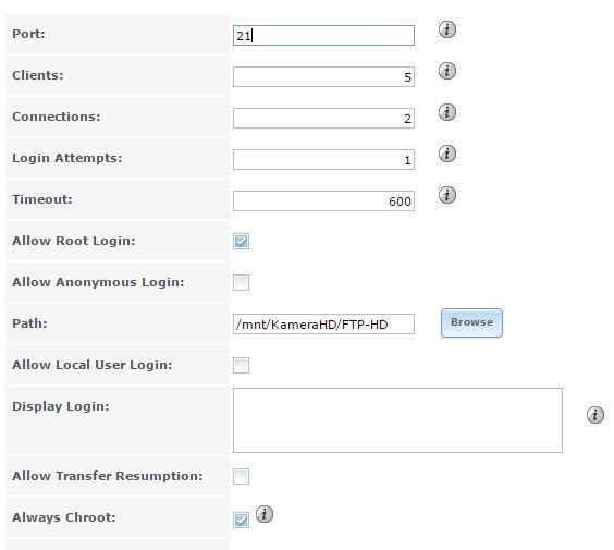

When I use chrome or Explorer to login using my user "SuperKim", nothings happens. The text fields are just being cleared and ready for a new user/password to be entered. using root works just fine.

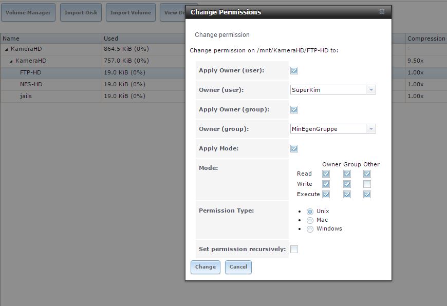

I have added a screenshot of my FTP pointing at my dataset, and the user of the dataset.
You can see my hardware and software in the signature

Set the checkbox for "allow local User Login"....
