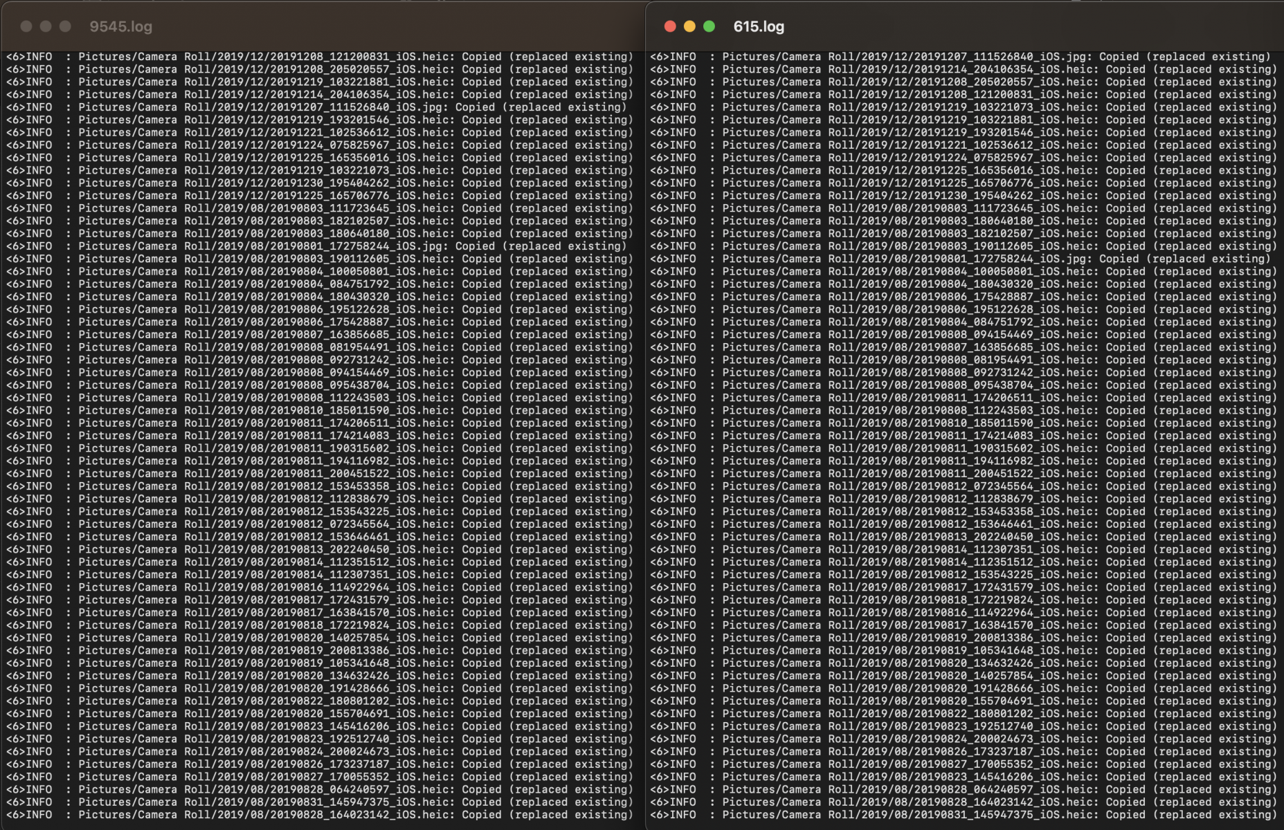

I have a sync relationship set up to backup my OneDrive to TrueNAS-SCALE-22.12.0. The configuration is PULL and SYNC without any special options. The job runs daily.

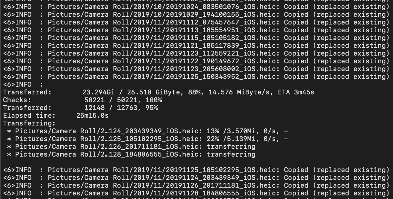

I have noticed that each and every run since weeks ago (not sure since when, this happens from the time logs are available) around 25GB worth of data is resynced. Total size of the OneDrive is ~500GB.
I am almost certain that this data did not change on the cloud copy, and the same data gets pulled again and again. See logs for two runs, from about 3 days apart:
While it's no biggie from a bandwidth perspective, any idea why content copied again and again? I am assuming the reason for copy is that it gets detected as changed on source, but why?
