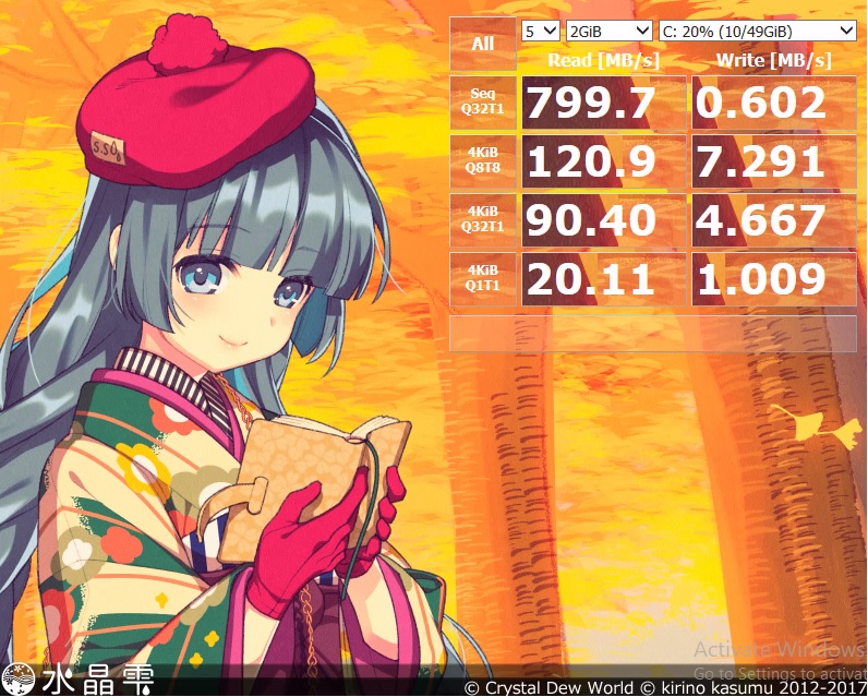

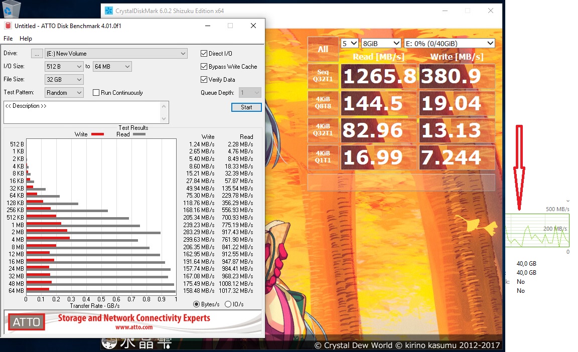

I've setup an ESXi with FreeNas.
Now I got 4 NVMe drives, which I passed to the freenas VM.
The performance is, well I would expect the same performance out of a floppy Z1 volume..
So clearly I missed some tuning and setup.
Are there guidelines, I couldn't find any, for NVMe pools?
Using 4 of those: TS1TMTE220S mounted to a card with a PCIe Switch. So maximum bandwidth is limited to x8 for all 4.
I don't see any errors within freenas or the log.
As a little reference I've tested the 4 SSDs with the card together with windows server 2019 and build a Storage Spaces pool with one drive parity and ReFS as file system.. with that setup I was able to get nearly the bandwidth of the PCIe x8 3.0..
Thus I spend some time googling for best practice for NVMe pools but didn't find anything.

With a Z1 pool, you're going to expect the IOPS of only a single NVME, so the way you're testing with tiny (512b) IO, is bringing that limitation to the front.
With that single NVME also in contention to write at the same time as the other 3 with the limited PCIe lanes, I'm not surprised to see IO is significantly worse than would be possible with 16 available lanes (and hence no contention).
I'm also not surprised to see nothing in the logs of FreeNAS about that, it's handled by the Chipset as far as I understand, so as long as the IO gets to the card eventually, there's nothing to report.

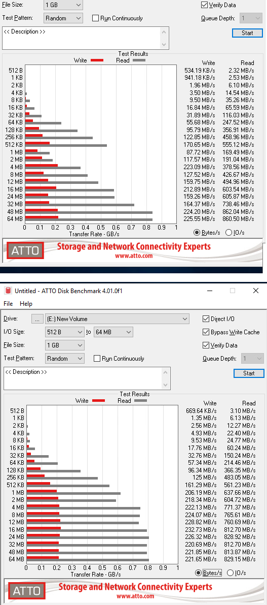

well I would be happy with 1/4 of the IO of a single NVMe.. as you can see from the test above it's way below.
Further more I had tested the card with the drives storage spaces and ReFS... that's as close as it could come to comparable to ZFS Z1.
Additionally as you could see it varies from test to test to way slower than an single 5.9k HDD...

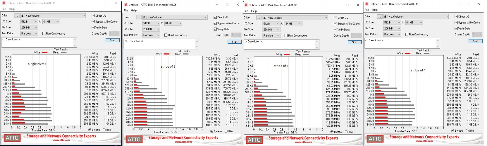

will test with single drive and report back
tested as suggested by @sretalla with stripes see below. no real performance impact.
while still best outcome is with 2 drives

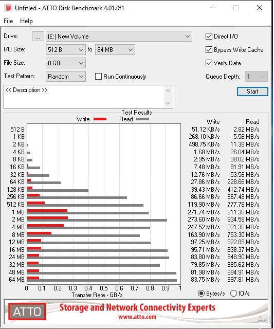

Digging further I noticed if I use large files with the stripe test. only tested with 4. performance will break down.
for insanity check I removed the nvme devices from the vm and attached them to the host. Than I created 4 vm datastores and put on each a single vmdk attached to the freenas. just thin provisioned for a quick test.
I've noticed to so good performance with that test but way better and more consistent than with freenas. noticed the bumps in write speed during the test from taskmgr. I assume the statement the nvme are fighting over bandwidth might be right.
I assume I need 2 x8 cards for 2 nvme each only so bandwidth is there.
