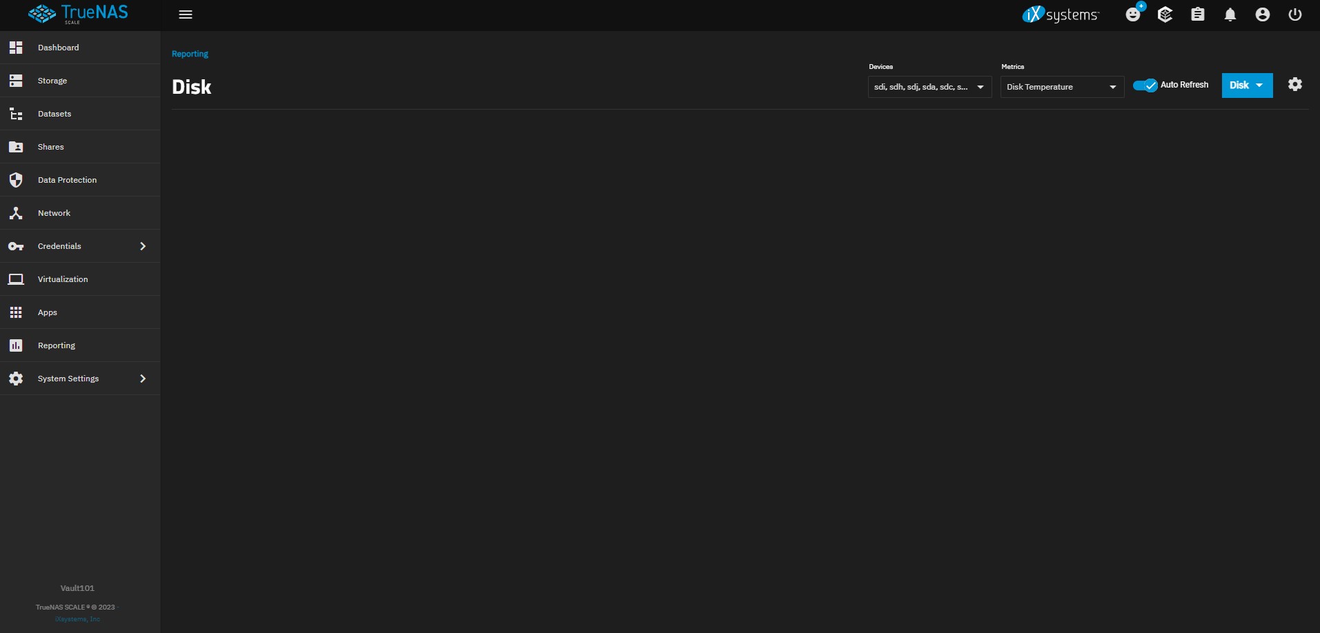

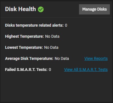

Hi all,
i just updated to the Cobia RC version and now no Disk Teperature is shown on the Storage Dashboard and Reporting Tab.
See the attached Screenshots.
I've already cleared my Browser cache and tried with chrome, firefox and edge.
Has anyone else the same problem?

I am seeing that the disk temperatures after upgrade are dropping to 0, but I am getting the reporting views showing, I suspect this is the same issue. Working on getting a bug raised now.

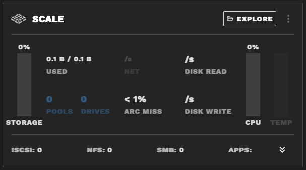

Also TrueCommand still does not show much data - was the case with BETA1, too.
The missing CPU temperature is because it's running on ESXi, but it definitely has got a pool.
All apps up and running, so mostly good work! :smile:

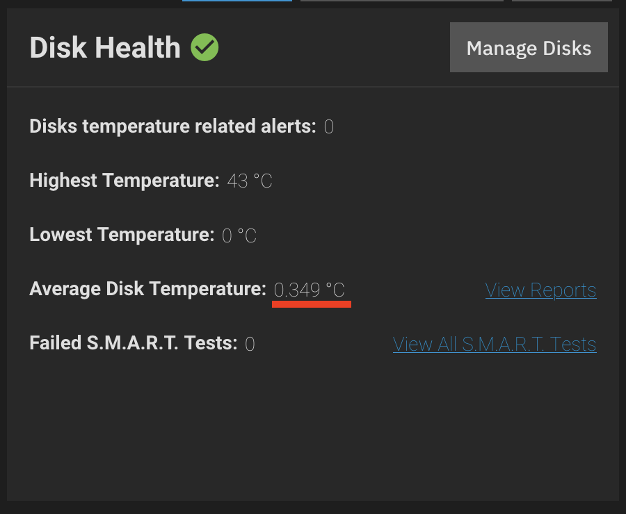

Hey, I just upgraded from Bluefin to Cobia 23.10.0 and I think I may be affected by this issue.
I have two NVMe devices which are reporting a valid temperature, but I have 17 SATA devices which are NOT reporting a valid temperature.
This is leading to crazy results like this:
Help please? :)
Help please? :)
Suggest starting a new thread with your hardware description. Any before and after on Bluefin and cobia is appreciated.
