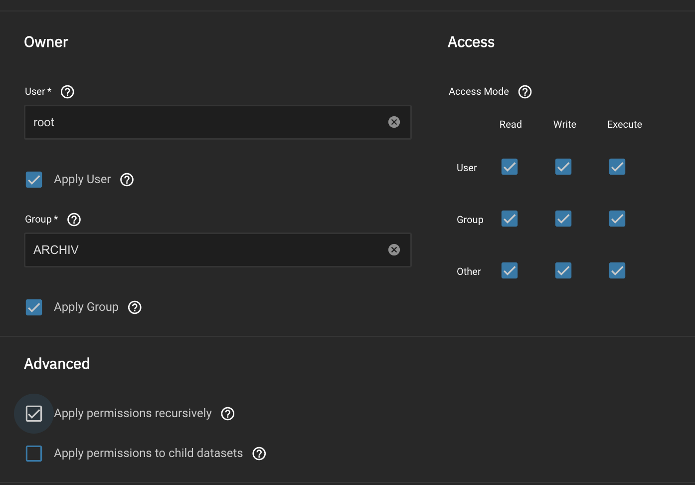

I'm running Scale 23.10.1.1 and have an NFS share containing two folders that just won't "accept" the ACL permissions. I have stripped and re-applied the permissions in this way to the entire Dataset.
However 2 of the folders on the top level (and everything they contain) of the dataset seem to be read only in a strange way. I can create a folder, but can't name it. I can also not write to that folder or do anything else.
Literally every other folder on that Dataset can be fully modified.
I've stripped and re-applied the permission multiple times to the dataset recursively but it's always the same two folders exhibiting this behaviour. I also tried creating a new folder in order to copy the content of the weird folder into that new one but this also leads to an error. I can play the media inside the folder (wav-files) but it won't let be copy them.

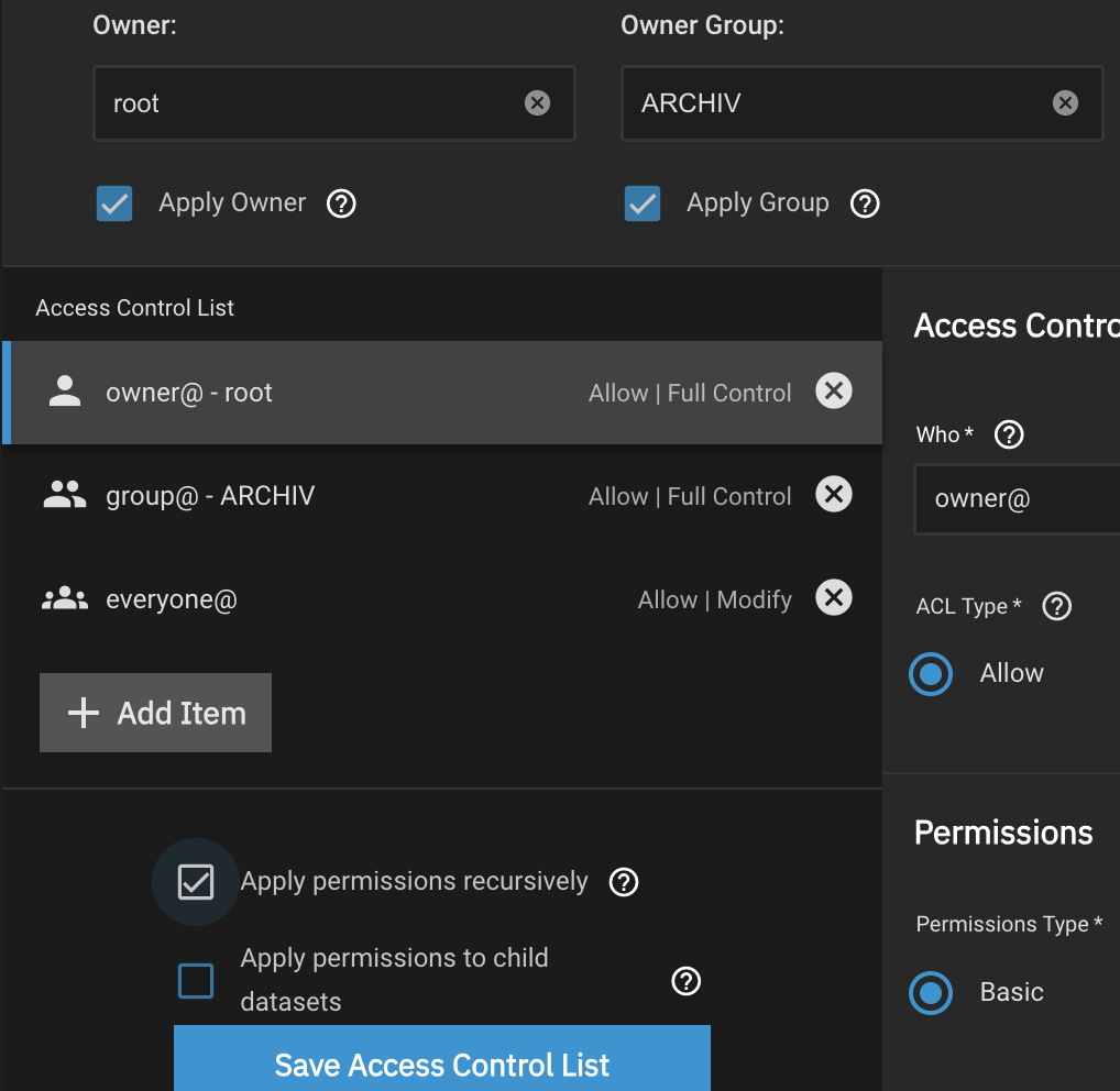

I also tried this after stripping ACLs but no change:

Tried some more things incl. switching to POSIX from SMB/NFS ACLs and back, again stripping and re-applying permissions recursively to the entire dataset but no luck.
I can also not delete those two folders in order to copy back an external backup. The only thing I can do it play back the wav files in OSX finder. Nothing else. Can't copy, can't delete, can create a new folder inside those two folders but can't rename it and I can delete it but just the newly created one. Nothing else in that folder.

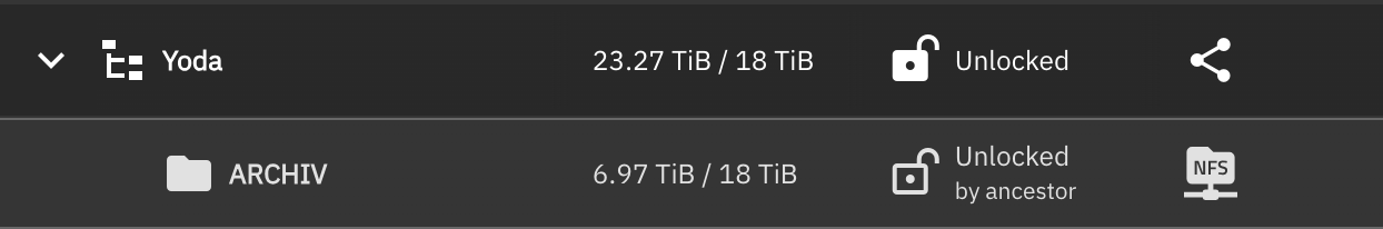

Are they directories or dataset mountpoints?
John45622
Dec 2, 2020
105
It's a Dataset setup as NFS share.
