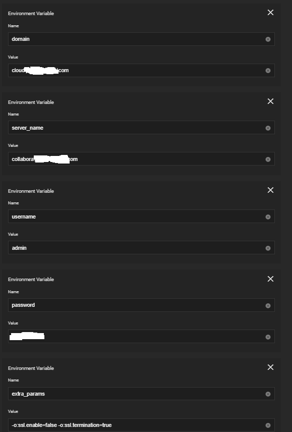

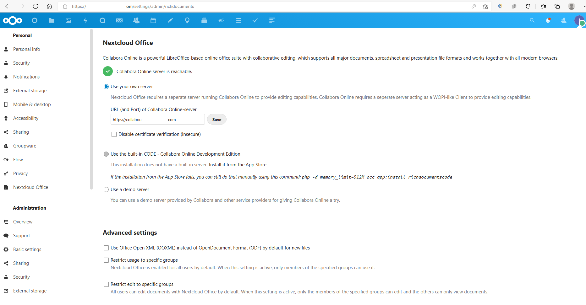

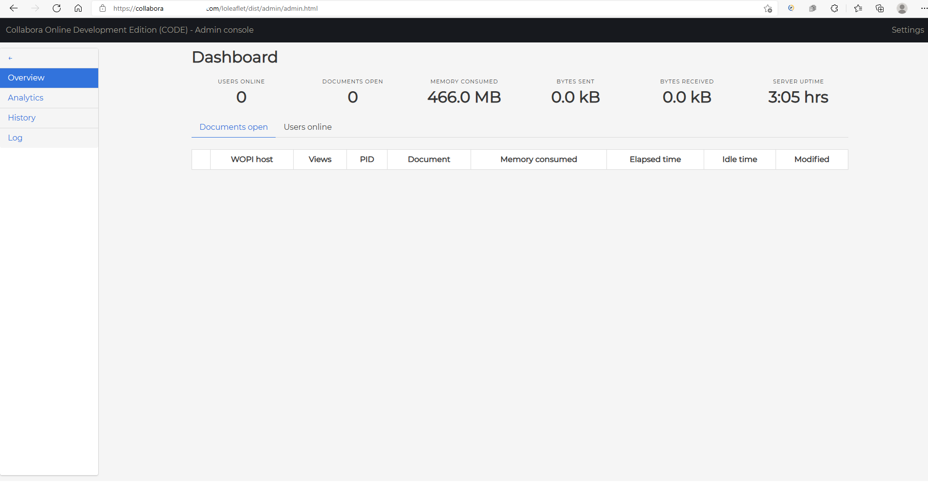

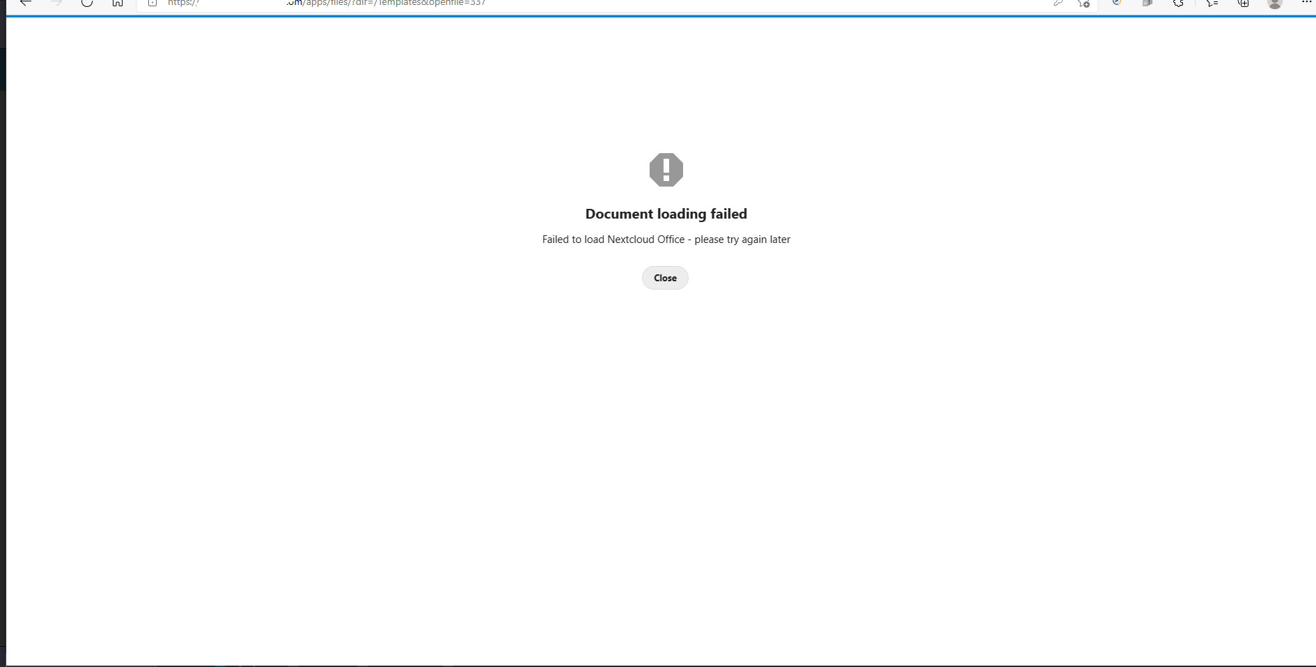

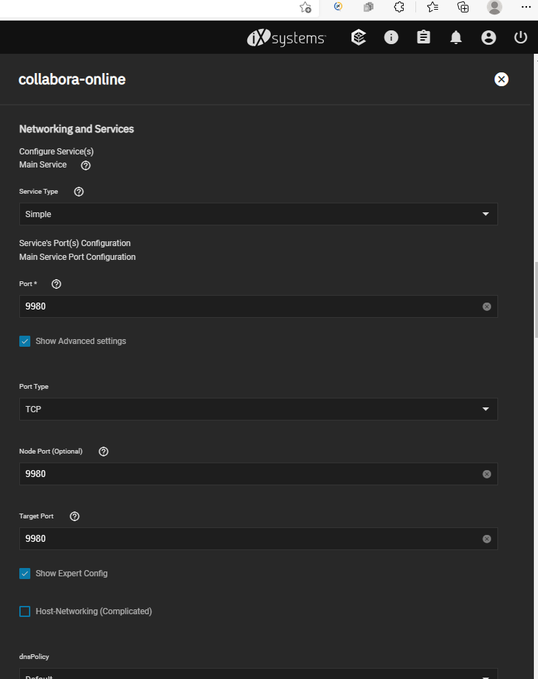

I'm running into an issue with Collabora and Nextcloud installed on TrueNAS SCALE (the most current RC). So, on the surface everything looks fine and should work. I have access to the Collabora admin page, and Nextcloud can reach the server. Everything is going through Traefik. I included some of the config screenshot for Collabora. I didnt' change anything else. Any idea what next steps I can take to troubleshoot?
I'm curious to know what version of SCALE you're using. I don't recognise the Networking and Services section in screenshot 26. I'm on SCALE 22.02-RC1.2 and I'm seeing Networking and Port Forwarding as different sections. See post #37.

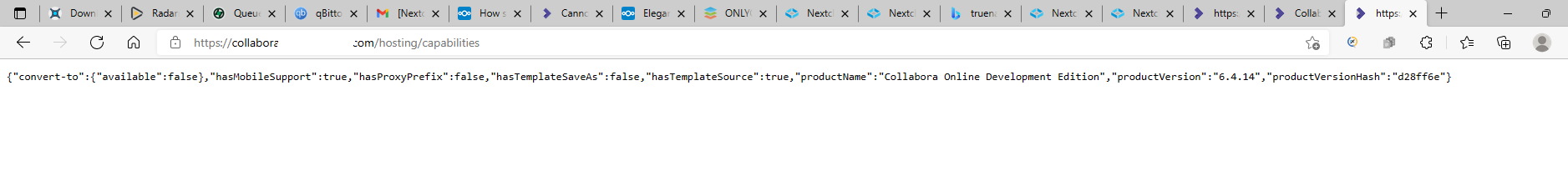

I notice Collabora is now an official app. Did you set Collabora up using the official app or by launching the Collabora Docker image directly? I did the latter as Collabora wasn't an official app at the time I set it up. If you use the official app, it looks like you'll end up on Collabora 6.4.10.10, which is quite old (around nine tag versions behind). If you install it using a docker image with the latest tag, you'll be on Collabora 21.11.0.5. I notice from screenshot 25, you're on Collabora 6.4.14. You might want to update to a more recent version of Collabora and retest.
I get the feeling from screenshot 22, you're using NC 23.0.0. I'm still on 22.2.3.

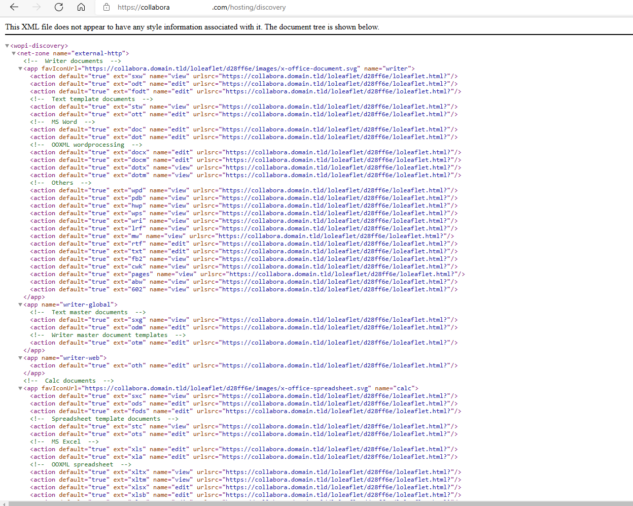

My previous install of callabora in a VM stop working so I destroyed it an did a reinstall. I ran into a problem in step 5.
There are three useful indicators:
1 & 3 work as expected but #2 gives this page isn't working HTTP ERROR 400.

It turns out that Nextcloud 23 made some changes that needs to be fixed in the reverse proxy. See list link.
The Caddyfile should be
collabora.mydomain.com {
        encode gzip
        @collabora {
                path /browser/* # Browser is the client part of LibreOffice Online
                path /hosting/discovery # WOPI discovery URL
                path /hosting/capabilities # Show capabilities as json
                path /cool/* # Main websocket, uploads/downloads, presentations
        reverse_proxy @collabora http://192.168.5.89:9980
I also had to reinstall the docker container but it all works now. Hopefully this will save someone else a lot headaches.

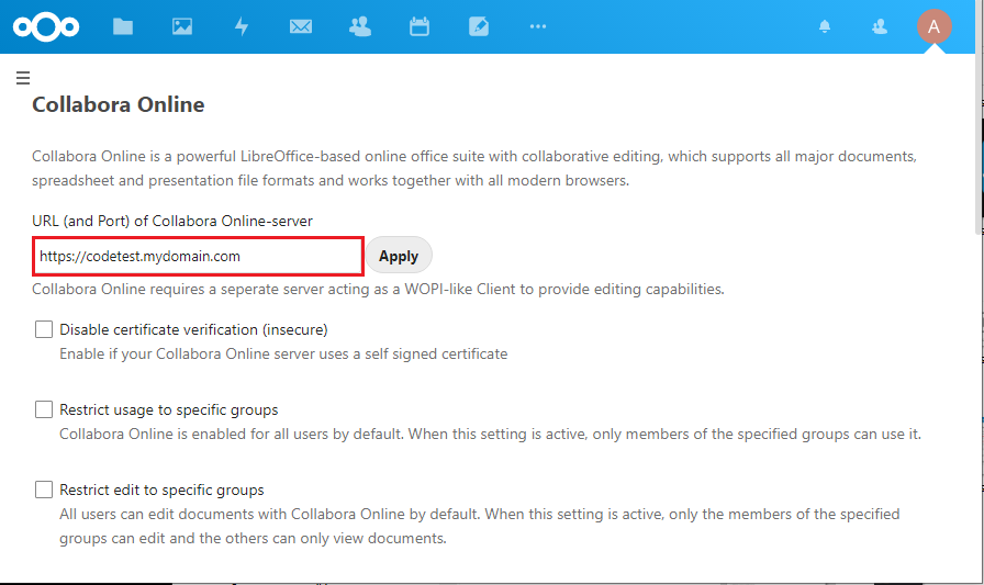

I'm trying to get this to work.
I have latest TrueCharts versions of Nextcloud and Collabora running through Traefik.
But, I don't see the app referred to in step 6: "Collabora Online connector". In the "Office & Text" section for apps I only see the two options to install the Built-In Server.

I think the name changed and it's called "Office Online integration"
indivision
Jan 4, 2013
806
Yep. That was it. Thank you!
The app to install is called "Nextcloud Office" now, to be exact. That creates a new section in the Administration settings called "Office" where you can point to your separate Collabora server. For me, turning OFF "Disable Certificate Verification" was needed.
