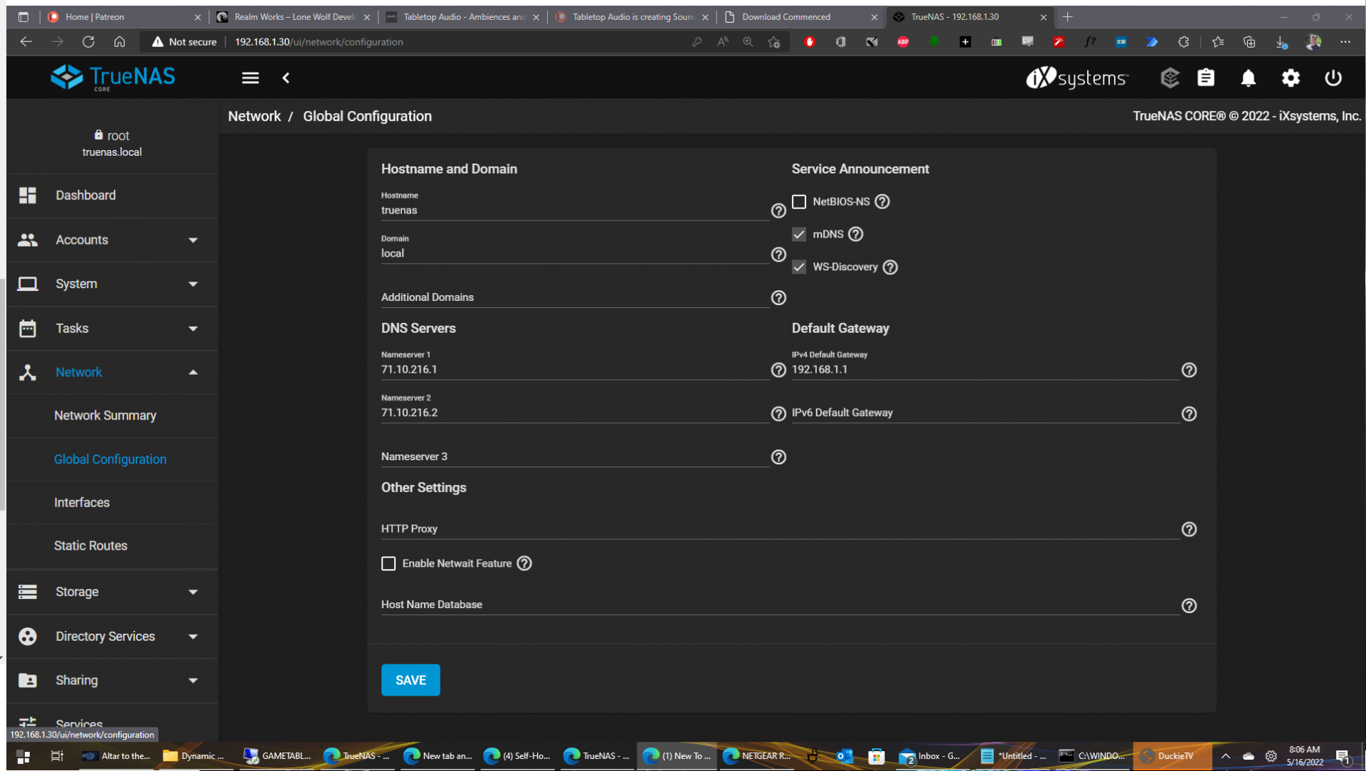

Please post a screenshot of your Network>Global Configuration page. I’m guessing that you don’t have anything listed for nameservers.
You could try your router/ gateway address there, also 8,8.8.8 and 8,8.4.4 if the router address does not work. .
Thanks for helping me out. Here is my screen shot. I did try the google dns settings but still had the same issue,

DHCP enabled on your router?
