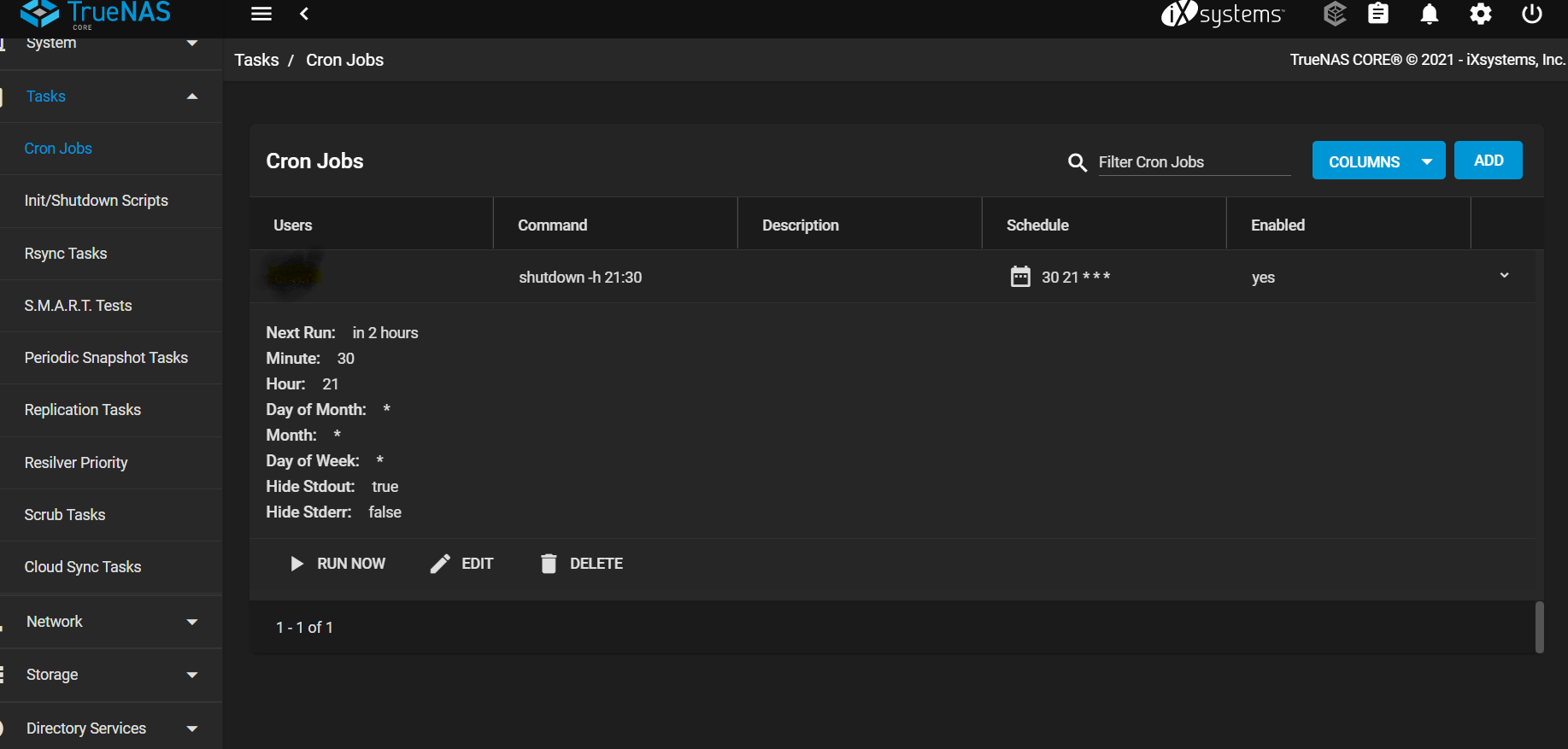

Is this correct for the cron task?
Patrick M. Hausen
Nov 25, 2013
7,776
The command should be shutdown -p now. Literally. Do not replace "now" with a time. -p is for ACPI power off which @elvisimprsntr missed.

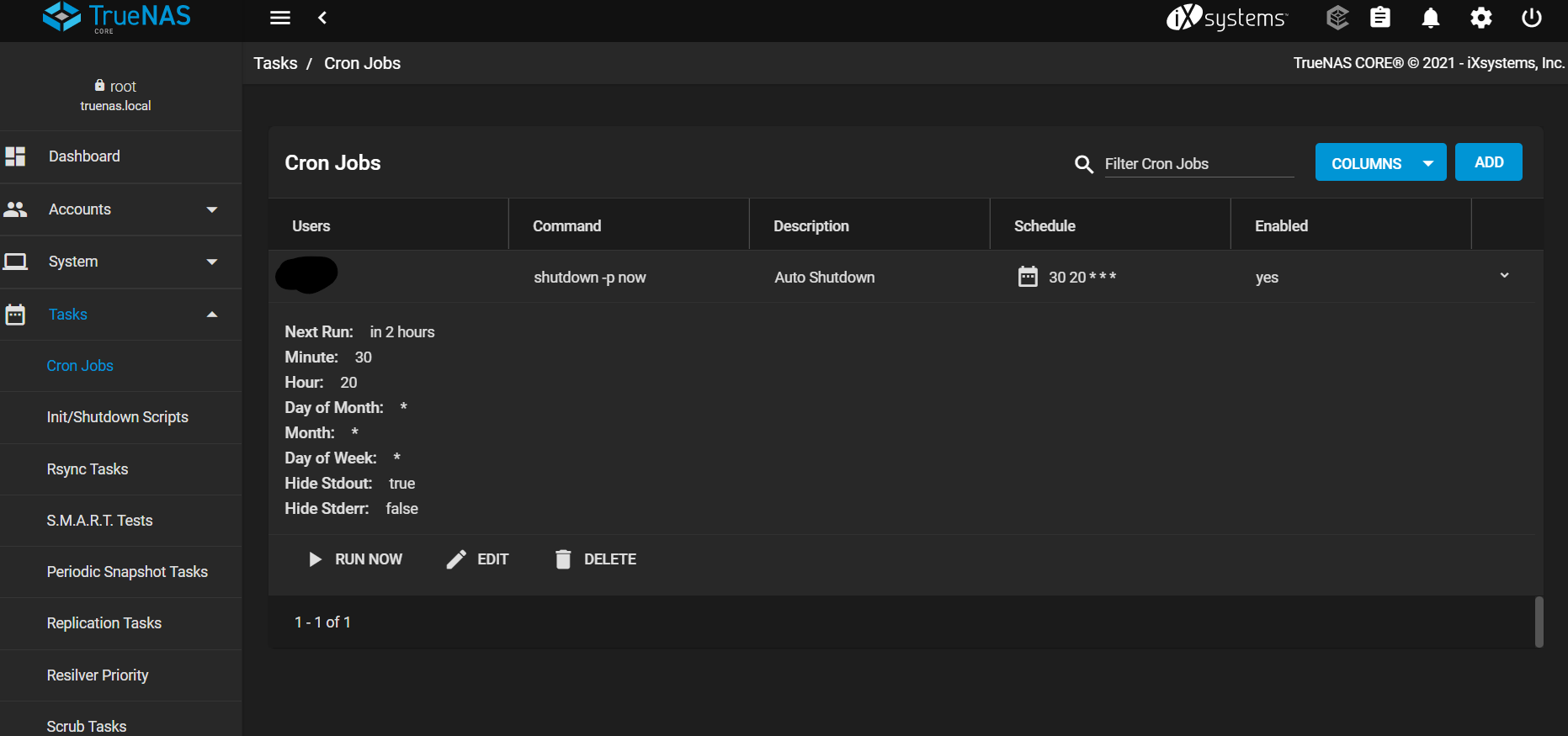

Ok, thanks, here is an updated screenshot of the cron job
I will test it soon

Jun 2, 2019
590
I will test it soon
FYI, Since you are running the script daily, you can leave months and days unchecked. The "*" is a wildcard, which means every day/month.

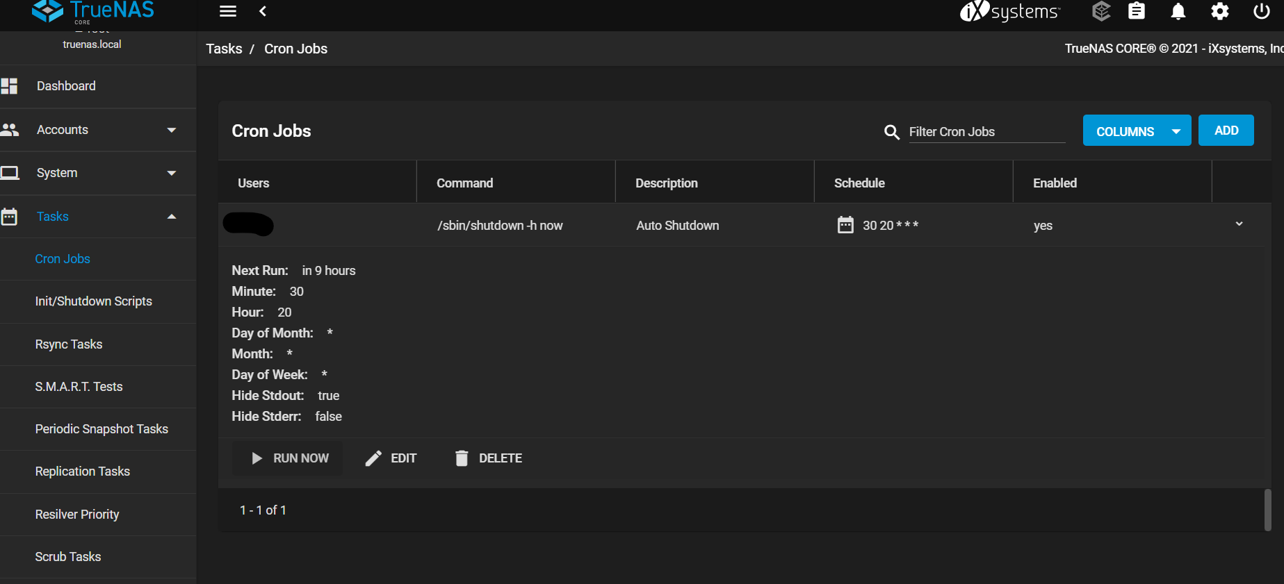

Unfortunately I've tried updating the cron job with /sbin/shutdown but still no luck. I don't know what you mean by WOL packets?
I have attached another screenshot of the cron Job

Patrick M. Hausen
Nov 25, 2013
7,776
Why did you remove the user from the screenshot? There is nothing security relevant to that information that could be exploited remotely. The command must be run as root of course.

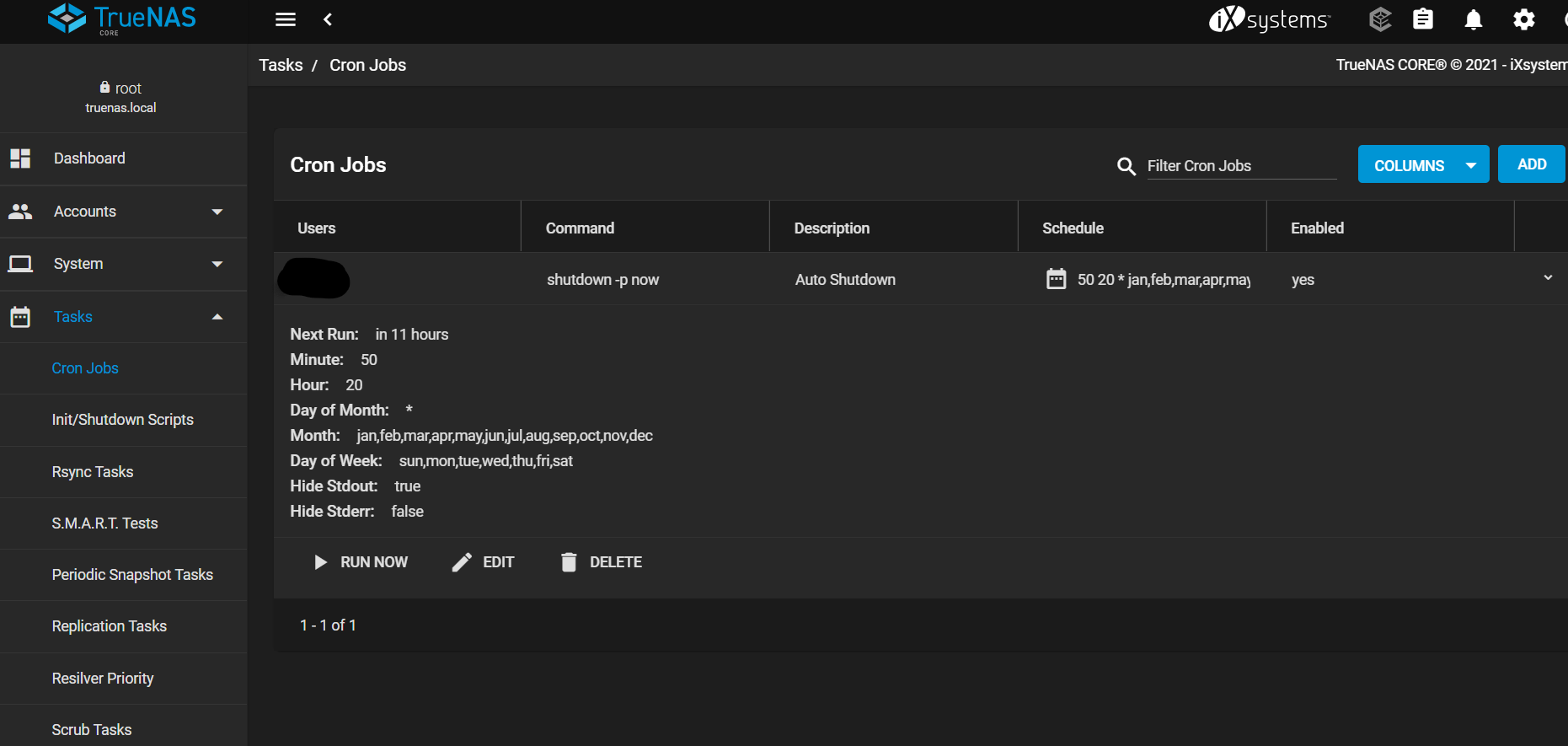

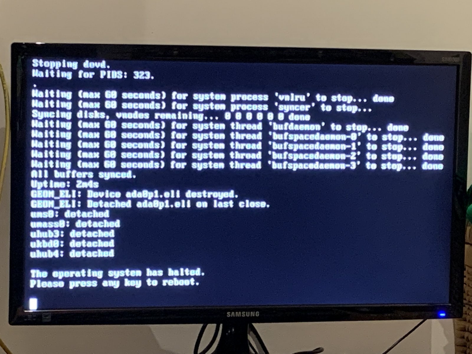

Unfortunately I now get a prompt to "press any key to reboot" on the NAS machine and pressing keys does not do anything. I also have to hard power off to return the machine to a working state.
Arwen
May 17, 2014
3,611
Please use the "-p" option instead of "-h", as been suggested earlier. FreeBSD works slightly different.
