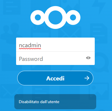

Hi, I wanted to ask how to re-enable the main account of NextCloud from "Shell", because from "manage" I cannot be that the account to re-enable it was just ncadmin

shout out the next cloud unofficial discord server the command is
php occ user:enable ncadmin
or you can do what i did and in the truenas shell
1) iocage console "the name of your nc jail"
2) occ user:enable ncadmin
