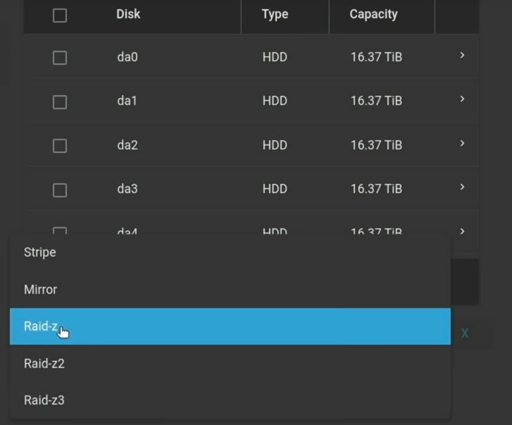

Did trueNAS remove the ability to stripe because I saw it in a video that you could stripe a vdev
Arwen
May 17, 2014
3,611
In ZFS terminology, a Stripe is across vDevs.
However, in other RAID schemes, they refer to RAID-5/6 as striping data across the disks in a RAID-5/6 set. While ZFS will stripe data in RAID-Z1/2/3 as a single vDev, it is NOT commonly referred to as a Striped vDev. It would properly be referred to as a RAID-Zx vDev.
With your insistence of no redundancy, their is exactly one ZFS option, 5 single disk vDevs, (aka Stripe).
