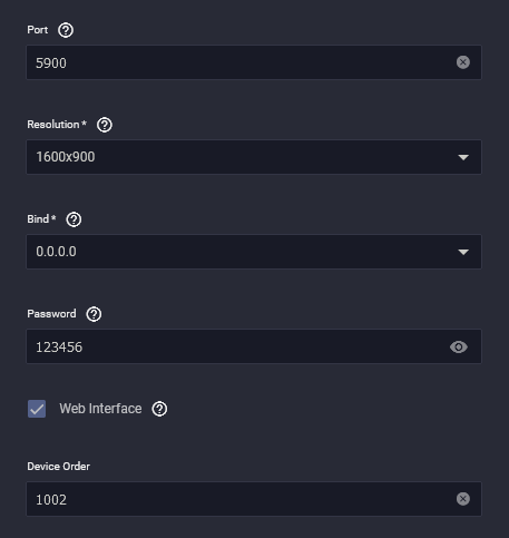

Hello,
I just added back a virtual display with the following settings
Since then the mouse and keyboard stopped working in Spice web view.
