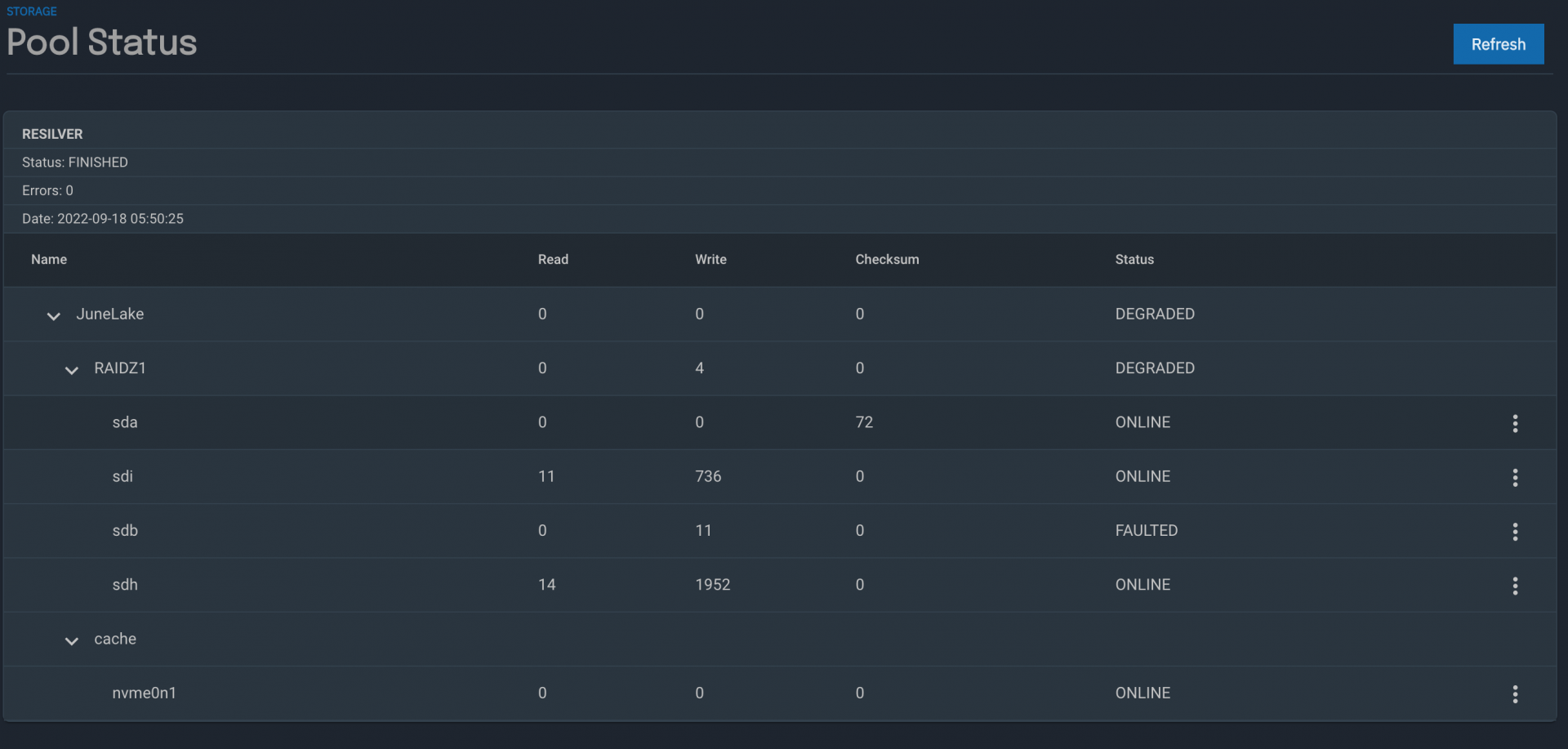

At the beginning of the month, I posted on here about my Pool Degrading and shutting down about 10 mins after boot. I ended up downloading Seagate diagnostic utility, long-tested each drive, and then swapped out the SATA cables. After that, the Pool came up and remained stable, my pool is still up, but about a week ago one of the drives faulted and I experienced a bunch of errors. I didn't notice, because there was no interruption in any of my services, until this week when I happened to log in and check.
Reading the forums I decided to run a long smart test on the faulted drive giving me the following output. It doesn't seem like there are any major errors and from my experience last time, its most likely a mobo, or SATA controller error. I should also mention that I have a PCI NVMe drive hooked up as a cache, that has never had an error of any kind.
A friend of mine is lending me a 9207-8i raid card and I am hoping that will allow me to circumvent what may be an issue with the mobo. But I would love any advice on whether or not I am pursuing the right path.

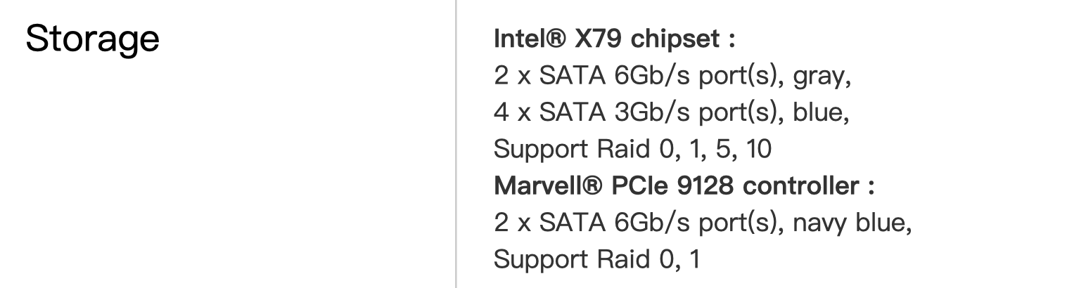

Your mobo has a RAID controller, which is likely a contributor. The mobo manual does not list that you can configure in AHCI mode. Even then ZFS may not get complete transparent access to the drives due to firmware in the controller.
Re: https://www.asus.com/me-en/Commercial-Servers-Workstations/P9X79_WS/specifications/
Substituting for another RAID controller will likely result in similar problems.

Thank you, should I do a zpool clear since the drive passed the test?
It appears I misrepresented the card. it is an LSI 9207-8i HBA, not a RAID. The card is not mentioned in the forum post linked, but some in the sam series are, like the LSI 9211-8i. It is also listed as fine by jgreco in this post.
That said, would the card still run through the Marvell raid controller on the mobo? Should I be looking at a new motherboard, and probably CPU?
Per your request, zpool status output:
  pool: JuneLake
 state: DEGRADED
status: One or more devices are faulted in response to persistent errors.
        Sufficient replicas exist for the pool to continue functioning in a
        degraded state.
action: Replace the faulted device, or use 'zpool clear' to mark the device
        repaired.
  scan: resilvered 3.27M in 00:00:01 with 0 errors on Sun Sep 18 05:50:26 2022
config:
        NAME                                      STATE     READ WRITE CKSUM
        JuneLake                                  DEGRADED     0     0     0
          raidz1-0                                DEGRADED     0     4     0
            612e0129-8cbb-4933-a35f-6f3bdcbc0c87  ONLINE       0     0    72
            02037d57-5b22-4a6a-8a37-4196d1bcc066  ONLINE      11   736     0
            0ad52698-6084-4086-adec-c602064f76a1  FAULTED      0    11     0  too many errors
            846551cd-7fb8-45b4-9884-c522355dac45  ONLINE      14 1.91K     0
        cache
          ee53604f-71de-4fa9-a977-198fa048bed8    ONLINE       0     0     0
errors: No known data errors
  pool: boot-pool
 state: ONLINE
  scan: scrub repaired 0B in 00:00:35 with 0 errors on Fri Sep 23 03:45:38 2022
config:
          mirror-0  ONLINE       0     0     0
            sdc3    ONLINE       0     0     0
            sdd3    ONLINE       0     0     0

The Marvell controller on the motherboard is not really a RAID controller; it's just a fairly crappy PCIe to SATA bridge that supports software RAID. It should definitely be avoided, but because of crappy, not because of RAID.
If OP hooks up the drives directly to the Intel chipset ports, all should be well. I believe they're generally regarded to be just as good as an external SAS HBA. With 6x onboard ports, 4x drives plus 2x boot drives should be fine.
