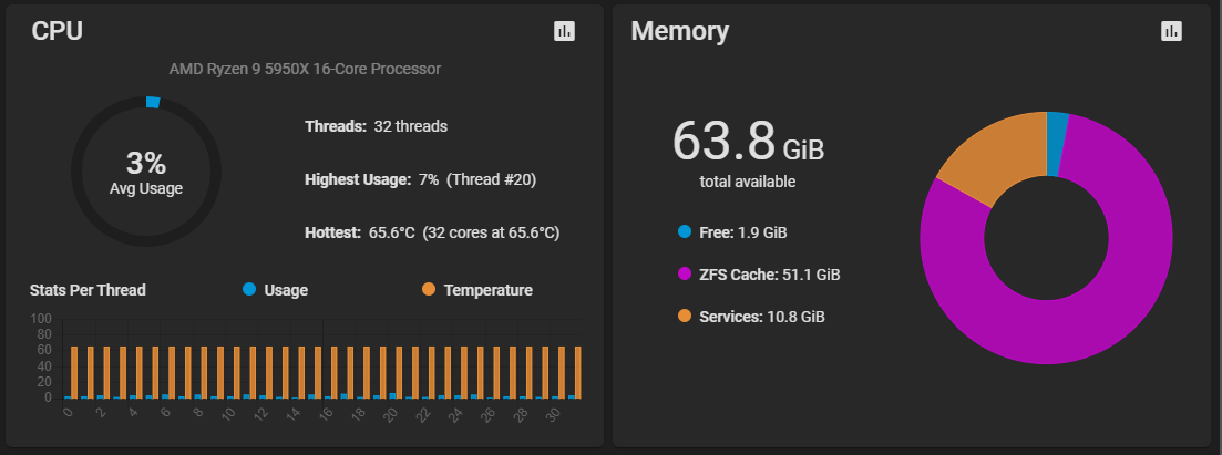

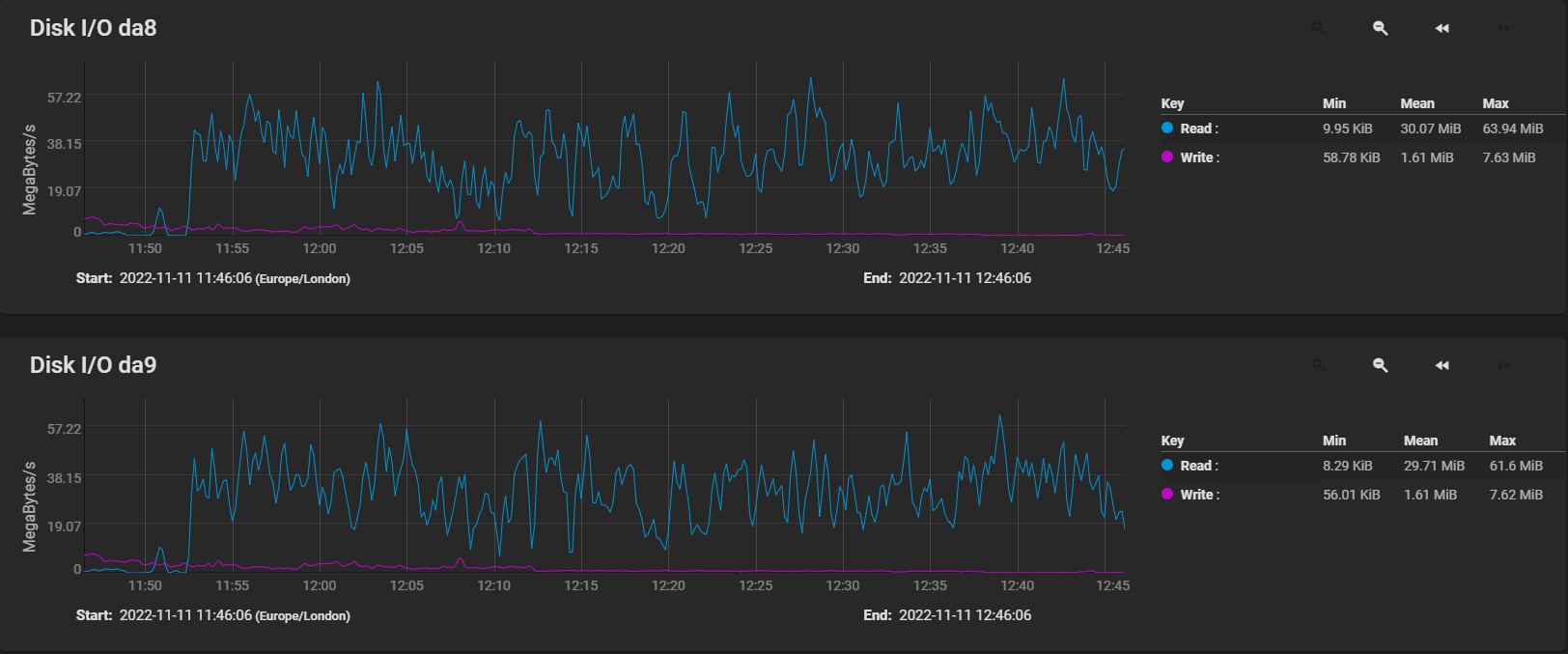

In the last couple of weeks we have experienced a massive drop in write performance from our production pool. Specs:
I don't believe it is a network issue as another pool with the same setup is currently running fine. This appeared to coincide migrating TrueCore from USB to SSD.
Production pool is currently at 77% of 60TB's. Though it was running fine at 90% capacity before the move to SSD.
I am a bit of a newbie, so if any more screengrabs/info will help, please let me know.
Thanks in advance.

This could be experiencing high fragmentation, which could account for slowness. ZFS is a copy-on-write filesystem, so when you replace a block, it allocates a new block in empty space, writes it, and then frees the old block wherever that was. This has a tendency to create free space in a scattershot manner which can be a performance killer as the system needs to start seeking heavily to find the smallish blocks of free space. This can have a dramatic impact on performance, and is one of the reasons ZFS folks are skeptical anytime someone comes in saying "it was running fine at 90% capacity" -- it quite probably wasn't, and rather it's likely that the damage wasn't immediately obvious.
Check to see how busy the disk is when you're experiencing the problem. Run "gstat -f da8" for example and see how busy the disk is. Here's an example of a relatively saturated disk:
dT: 1.012s  w: 1.000s  filter: da3
 L(q)  ops/s    r/s   kBps   ms/r    w/s   kBps   ms/w   %busy Name
    2    856      8     99   27.7    846  56210    1.8   86.8  da3
    0      0      0      0    0.0      0      0    0.0    0.0  da3p1
    2    856      8     99   27.7    846  56210    1.8   86.8  da3p2
It's still sustaining a high level of writes per second and kBps written per second despite being 87% busy, but as the percentage of seeks goes down, those metrics will fall.
