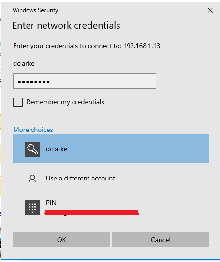

My boss bought a new PC and gave me the one he was using. I reset to factory settings and set it all up again but now I'm having this error message when I try to map the network drive:

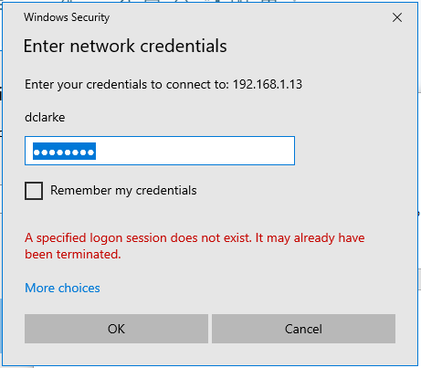

This is a different login box than previously (including on this machine before it was reset) and offers the below response when I click 'use different account' and enter my credentials:
It should also be noted that the new PC my boss bought works fine as does my previous machine.
To be clear, the settings on freenas have not changed, my credentials work on other machines and I am running the same OS on this PC as before the reset when it worked without issue.
Any assistance would be greatly appreciated as neither of us are clever enough to solve ourselves.

If you've signed into some Microsoft cloud services, AD, or other fu, you might need to use the workgroup name of the NAS, the name of the NAS, or some other sort of Microsoft-stupidity thing as the domain and include that in the username field. Try
NASNAME\yourlogin
or
NASWORKGROUP\yourlogin
for the login names. Note that this implies you may need to go to "More Choices" and "Use a different account"

You can view a log of authentication failures over SMB by running the following command:
midclt call smb.status AUTH_LOG '[["Authentication.status", "!=", "NT_STATUS_OK"]]' | jq
Piping through `jq` pretty-prints the JSON list.

You can try clearing the credentials cache and rebooting the computer.
From the CMD prompt:
net use * /d /y
You'll either have to reboot the computer or restart explorer.exe for it to take effect. (Rebooting the computer after clearing the credentials cache is a more sure-fire way to test this out.)
First try @jgreco's suggestion of More Choices > Use a Different Account > manually enter workgroup\loginname
