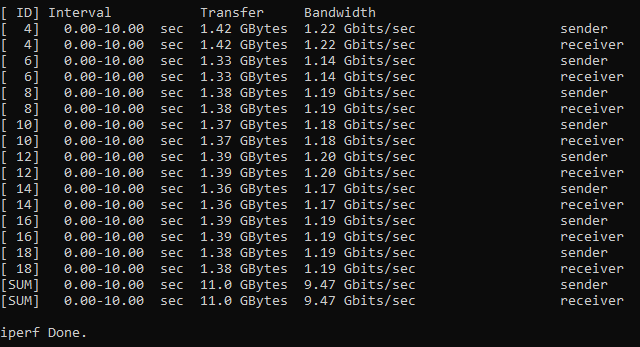

You were spot on.
I didn't get around to changing the configuration of my server before yesterday, but changing the X520-DA2 to the PCI-E slot above, presumably connected to the CPU rather than the chipset, solved the issue.
Running: iperf3.exe -P 8 -bidir -c 192.168.1.147
I got:
9.47 Gbits/sec is about what I expected to begin with.
Without the parameters @sretalla provided, it was stuck at ~5 Gbits even after the PCI-E slot change.
It seems you both solved my issue. Thanks a ton!
