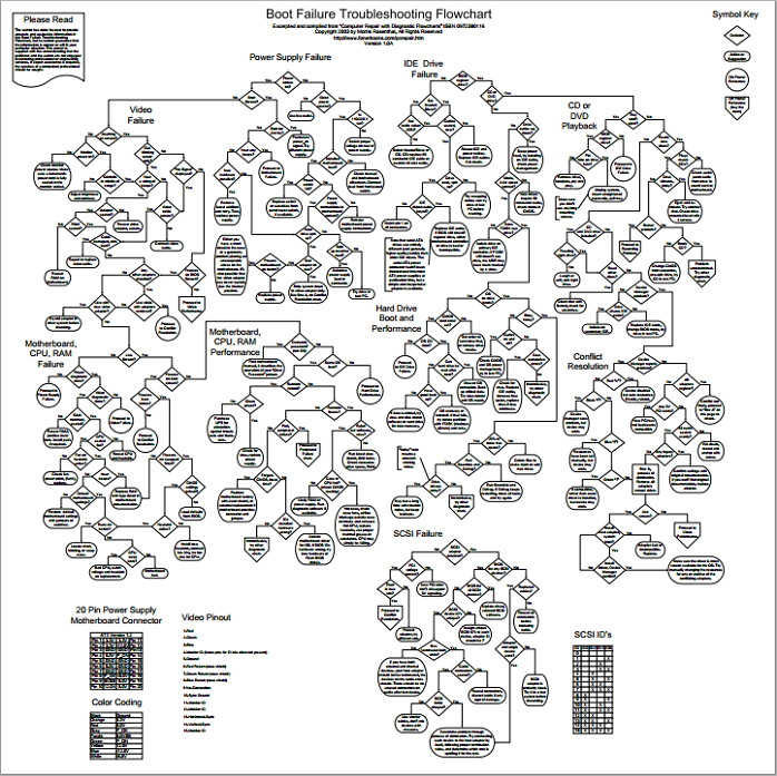

When it comes to ZFS, L2ARCs and slogs, the flowchart is not simple. It would look something like this...
Unless you are about to dive into ZFS and have the knowledge to create the flowchart yourself, you're stuck listening to the somewhat generalized experience of this forum. For this reason, the obvious answer to 99.9% of people's questions is to just blindly do what we recommend around here. Unfortunately a large percentage ignore that and do what they want because they think they know better. They don't, and they are simply throwing money and performance away when they don't want to listen. Sad, but also true.
