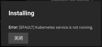

I didn't take any steps on my own to get Kubernetes started. I let truenas handle that. And the first time I try to create an app I get "Kubernetes service isn't running" error in a pop up alert in the ui. Oddly there's no kubernetes service listed in the services section of the UI as one would expect after such an announcement.

I have this issue too.
Kubernetes not coming up on a 21.06-BETA1,
