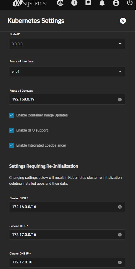

Greetings Lately i have an issue that i am not sure if i cause it or the pods update before the apps could have acess to internet but now they all fail to access the internet for example: home assistant cant update the weather Nextcloud: cant update their installed apps i can access them thru https: but the pods themself seems cant access the internet. here are some configurations screen shots
I do have Traefik running properly can any one point me where should i look please?

Considering you're using Traefik, it might be good to note that we do not offer support on the forums and our support staff is only/primarily available on our support discord.
However, traefik has nothing to do with outgoing traffic.
In your case, I doubt your router (aka gateway) is located at 192.168.0.19

you are 100% correct that the server internal ip.
changed the ip to the correct one fixed the problem thanks a lot i overlook XD
