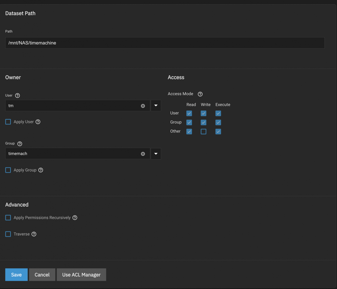

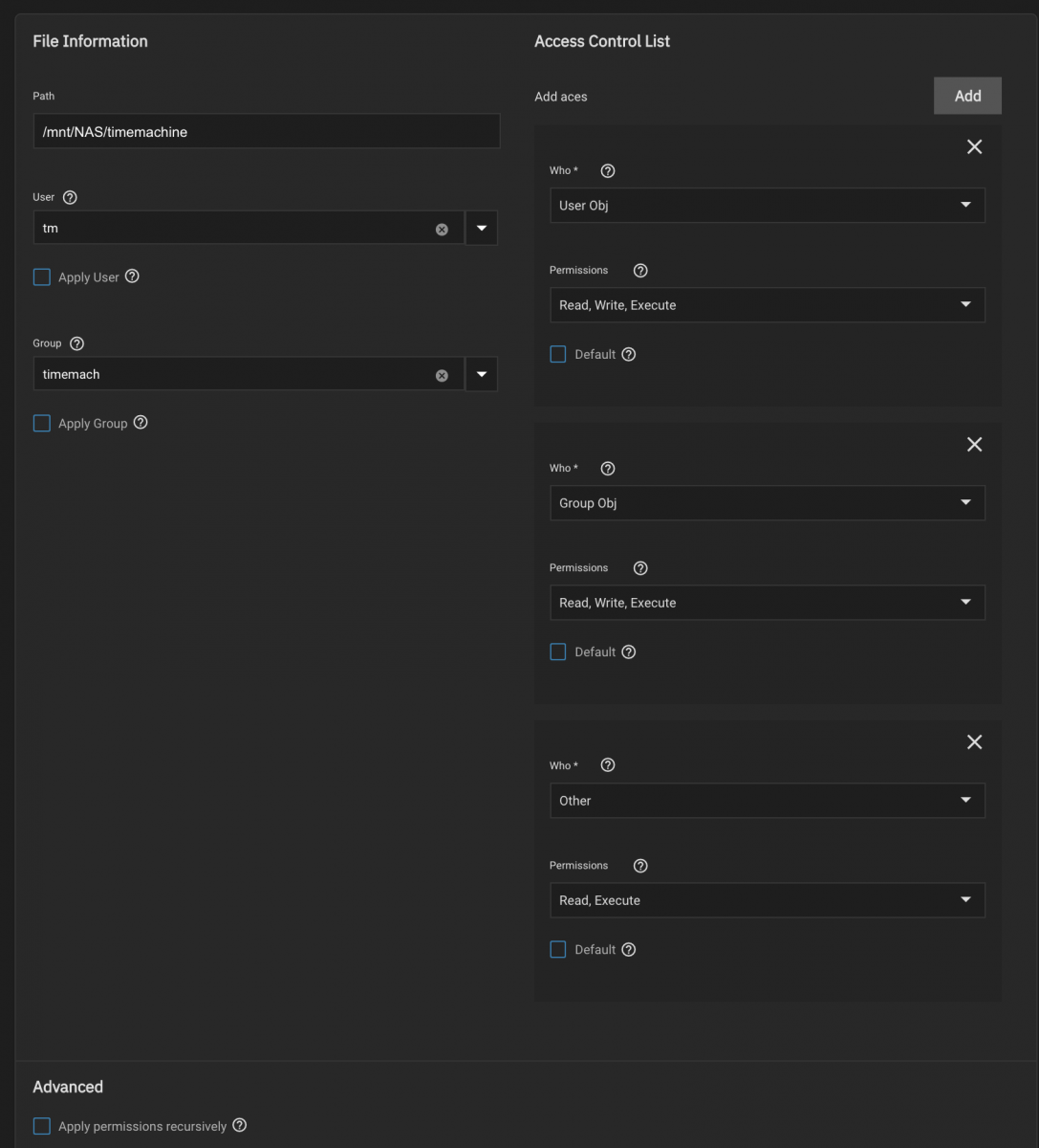

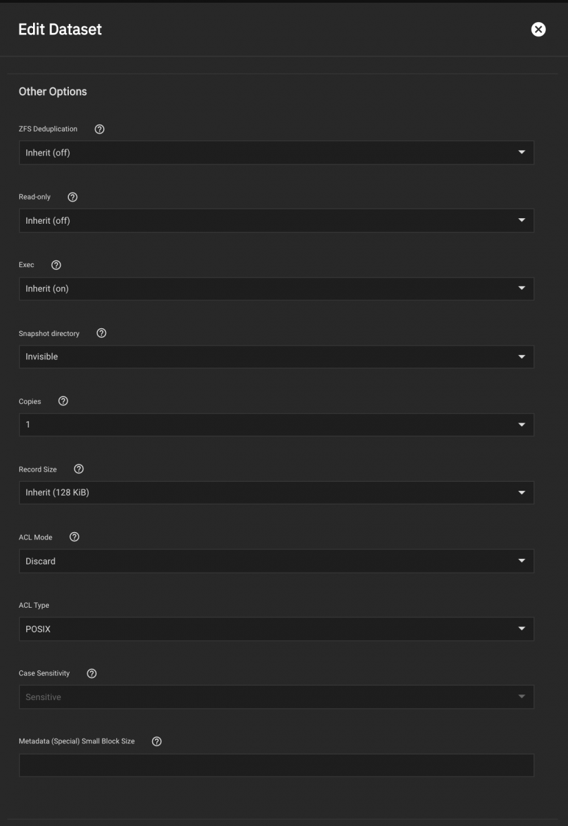

vega2004
Apr 18, 2021
19
Strange maybe you can check your options if you see a different
vega2004
Apr 18, 2021
19
I solved the problem for me to set the chmod of the folder manually I think it is the wrong way but I have to figure out what the problem is

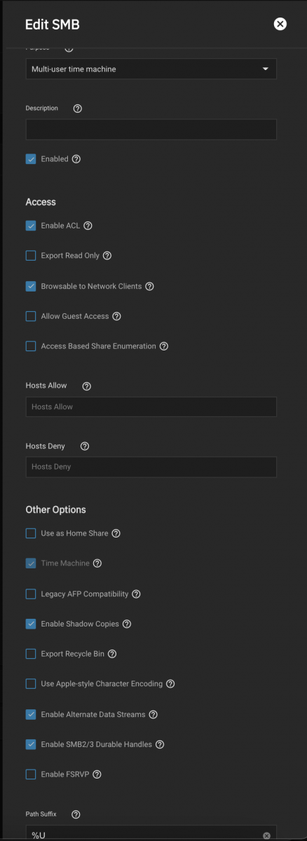

JMY1000
Feb 24, 2022
16
Nothing really.
Chose "Multi-user time machine" preset
and now the settings are:
"Enable ACL"
"Browsable to Network Clients"
"Time Machine"
"Enable Shadow Copies"
"Enable Alternate Data Streams"
"Enable SMB2/3 Durable Handles"
Cool, I was able to get things to show up as a valid Time Machine target after adding a separate dataset for Time Machine. Unfortunately when I connect to the new share, I'm seeing a significantly less free space than expected, which is preventing me from backing up.
