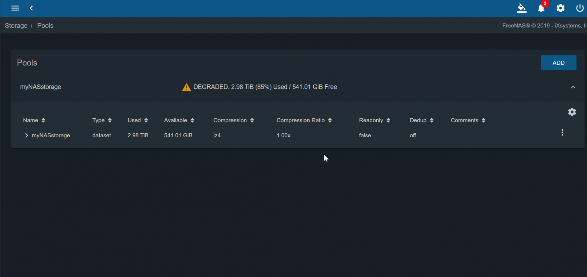

ok, i detached one of the discs, and got an alert :
Pool myNASstorage state is DEGRADED: One or more devices has been taken offline by the administrator. Sufficient replicas exist for the pool to continue functioning in a degraded state.
Wed, 18 Mar 2020 19:05:17 GMT
Then i went to pools and now there is an option to wipe, on the one that is detached, should i do it and then how do i add it back just as storage?
And also, should i just leave the one that is attached like that? In the "degraded" state?

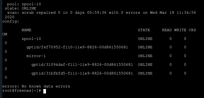

I am very interested in this thread. My 4 disk setup of a pair of mirrors has been working well, until recently the pool was flagged as degraded. I was able to identify the bad disk, and removed it. I am ordering a replacement drive, and have a complete backup of everything on a different device.
Surprisingly, the pool now appears as healthy, even though 1 of the mirrors incomplete. How can removing the bad disk, with no replacement make the Raidz2 setup healthy ? It now shows the pool as 2 mirred vdevs..I have 75% of the original setup ... I am missing something here ...

Originally it was set up with 4 drives, of 2 mirrors. Now I have 3 drives and 1 mirror.
9,700
I can't get to that... can you try another way? best is if you can use ssh or putty from your computer and copy/paste directly from the text into code tags in the forum.
kappclark
Oct 16, 2019
99
9,700
Better, now I can see.
This is exactly as you described, 2 mirrors, 1 mirror with 2 disks (mirror-1) striped with a single disk.
This is a valid setup if it was intentionally like this (although I agree it's not a setup that anyone really wants).
So what to do?

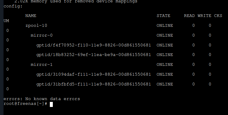

If you have a new disk inserted, you will need to partition it manually and then manually attach it to the single disk to get back to a pair of mirrors. Let's assume the new disk is ada3 and is already blank/wiped (if not, gpart destroy -F /dev/ada3)...

What you're looking for is the rawuuid of the data partition (so in the section for ada3p2): 1b28c891-69c9-11ea-b524-5d55812e7307 in this example
Then use that in the command to attach the new one to the existing lonely disk:
zpool attach <poolname> gptid/<gptid from zpool status of lonely disk> gptid/<rawuuid of data partition from gpart list>
zpool status -v to show it's all good.
I saw an issue with the ashift property when doing it on my test setup and needed to use -o ashift=9, but I don't think you will see this with real disks
kappclark
Oct 16, 2019
99
BRILLIANT !!! Thank you so much for this -- you saved me some real heartache ! The data is resilvering now...

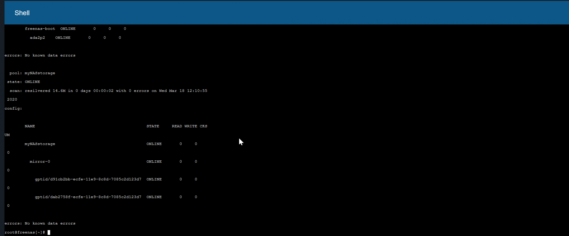

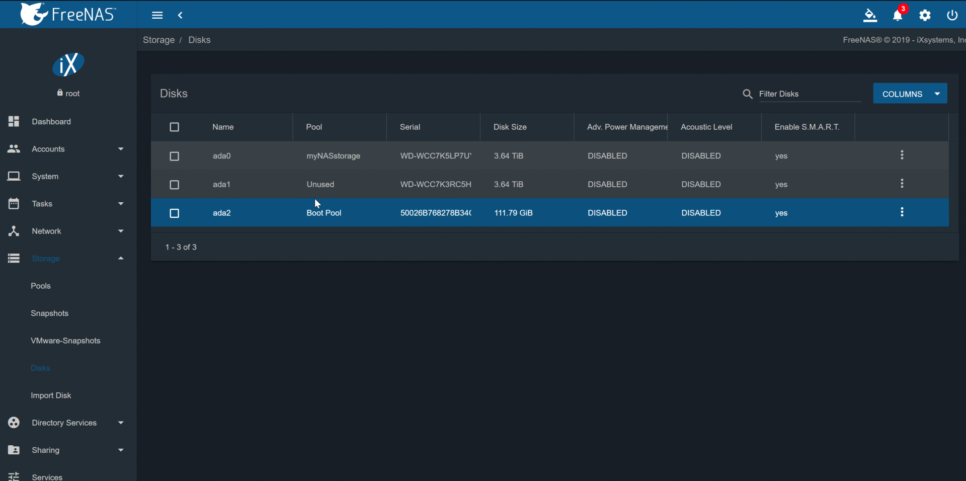

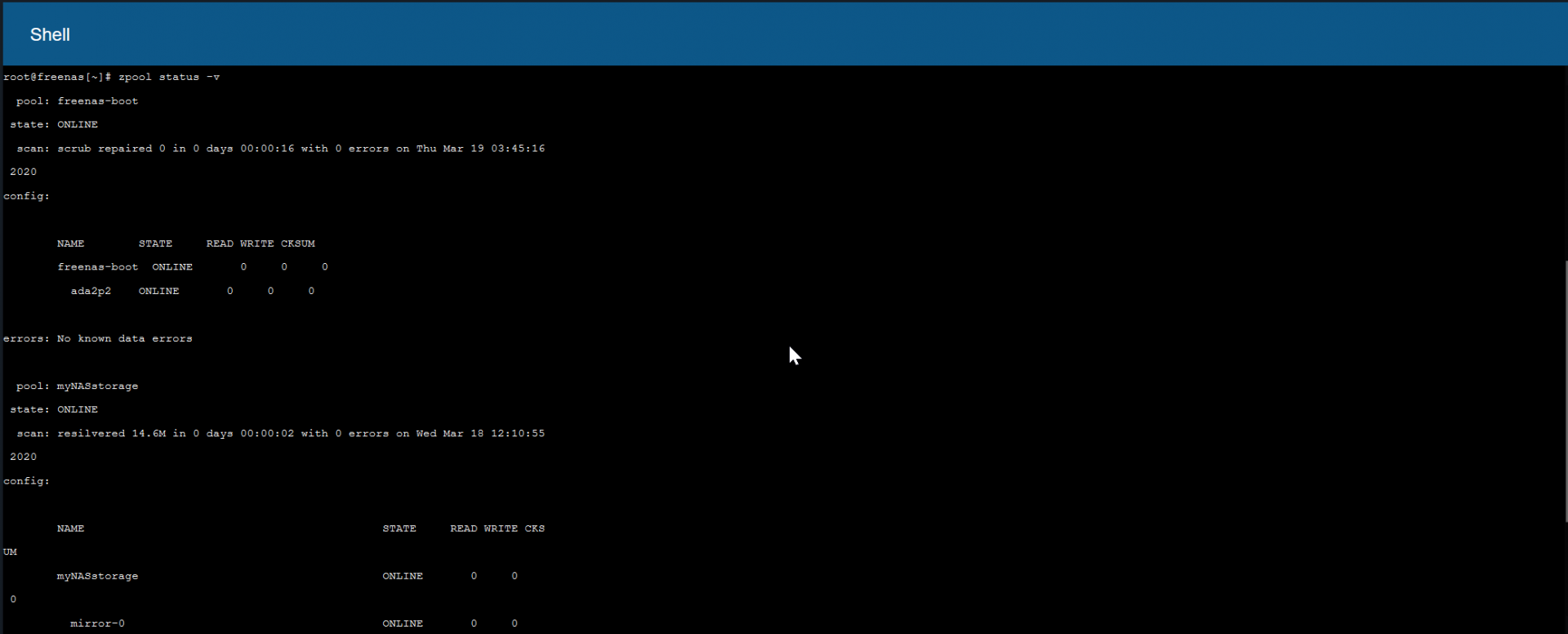

sorry, I can't reply that fast, I work in the medical sector here, we have more important things to teal with right now then my private NAS server. So might take some time for me to write back.
It only says "Degraded" when one of the Discs is detached.
9,700
OK, so it looks to me like the disk was not detached and we still have a mirror. If you follow the steps in the GUI, as we covered at the top, and this time offline the disk first, then detach it.
If that's not getting us the result, we'll go to the command line.
Also to confirm, when you say detach, we're talking about in the GUI, not actually detaching it from the hardware perspective.
