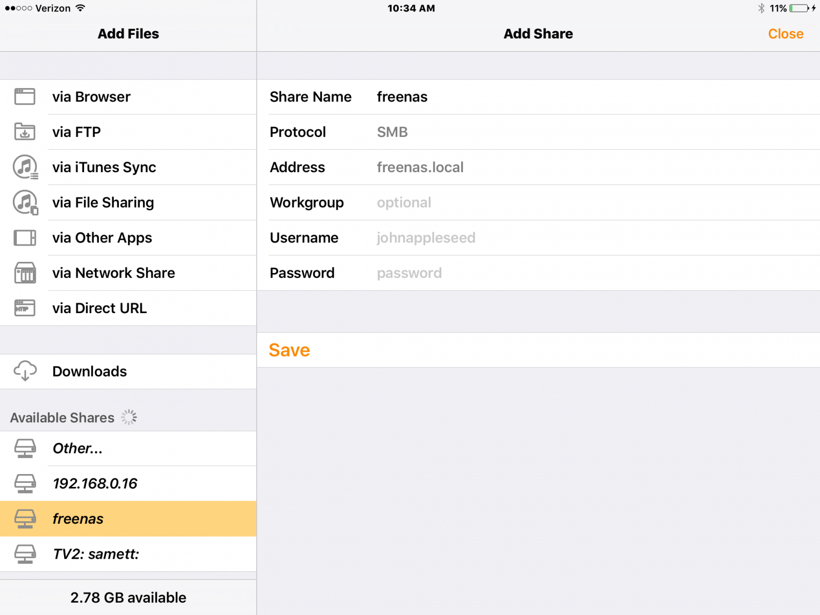

I use guest access and CIFS for my Home network on a fixed IP address 192.168.0.193. Infuse finds my freenas as freenas.local (fn1.png):

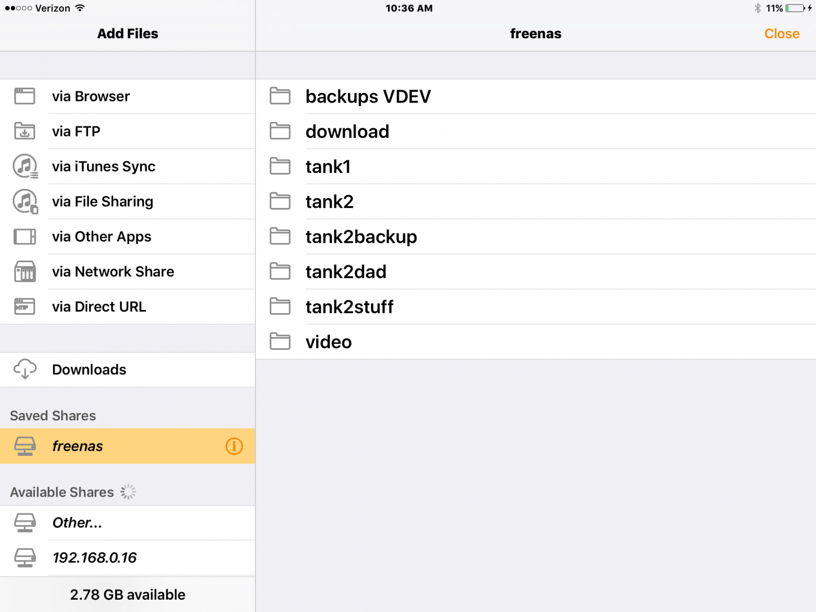

Clicking on "freenas" I see my CIFS shares with guest access. (I have other backup shares with password access.) (fn2.png):

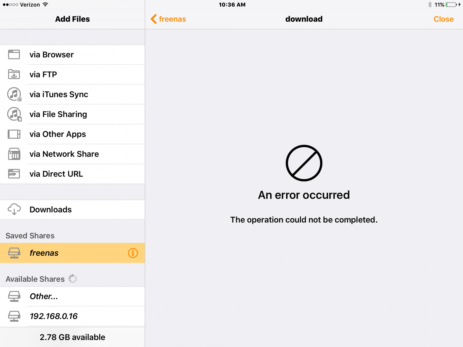

Clicking on one of the shares causes an error (fn3.png):

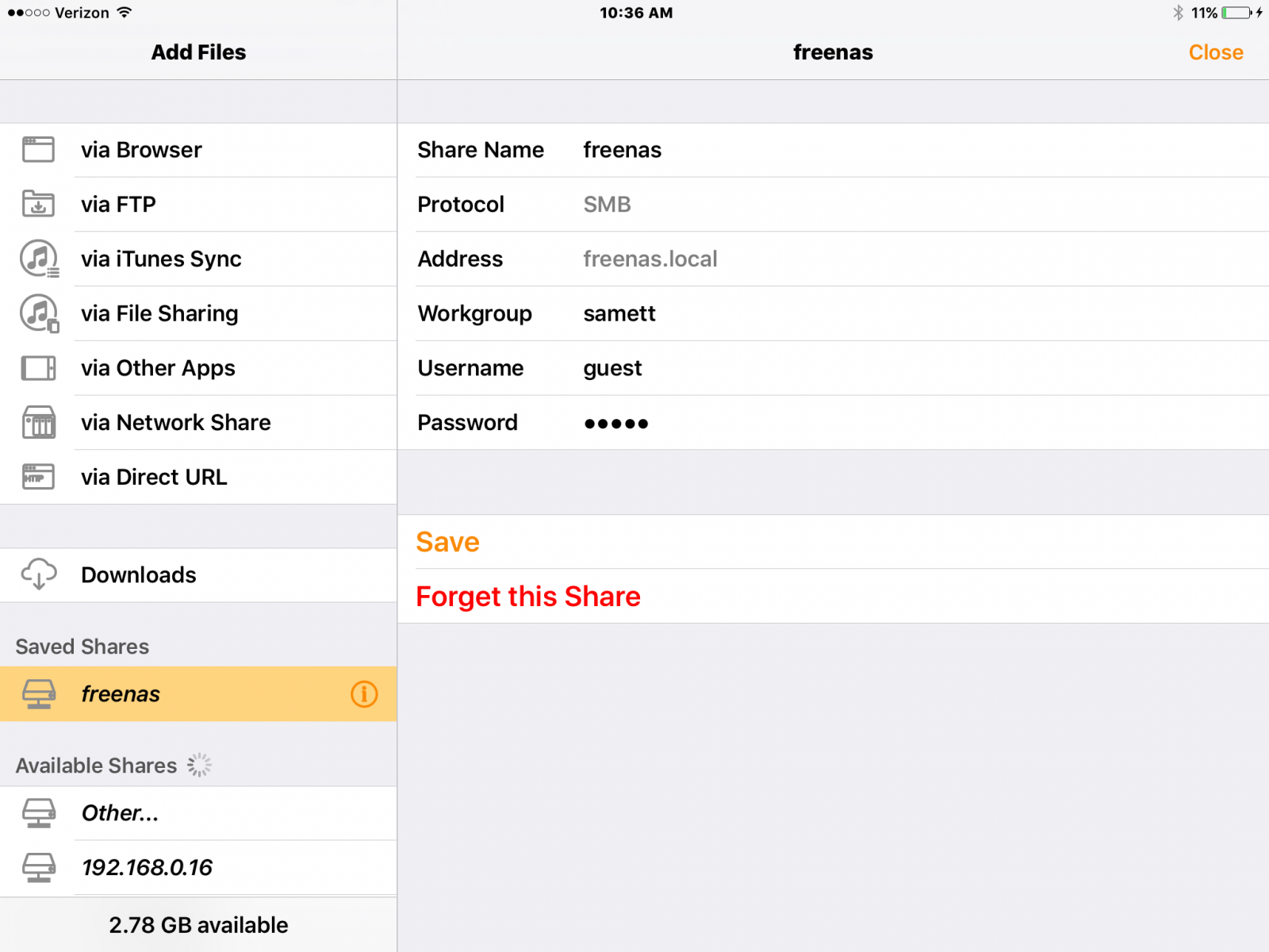

I try specifying Workgroup and Username/password: guest/guest without a change(fn4.png):

Well, that wins the award for most useless error message :smile:
Anything in /var/log/messages on the FreeNAS side?
