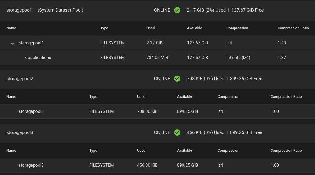

My storagepools are dual drives that are mirrored. There's a boot pair of 140GiB, then pool1 is also 140GiB, then pool2 1TB, and pool3 1TB.

How would I merge storagepool2 and storagepool3?
You can't. OpenZFS doesn't currently allow for merging pools. You'd have to backup both pools, destroy both pools, create a new pool from the members of both pools with a compatible topology, and then reload the backup.

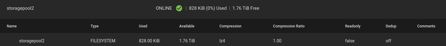

OK, storagepool3 'disconnected'.
Storagepool2 represents two 1T drives mirrored.
Storagepool3 was also two 1T drives mirrored.
Do I mirror the two drives that were storagepool3 but name them storagepool2?
Or ??
Sorry for all the questions ...
