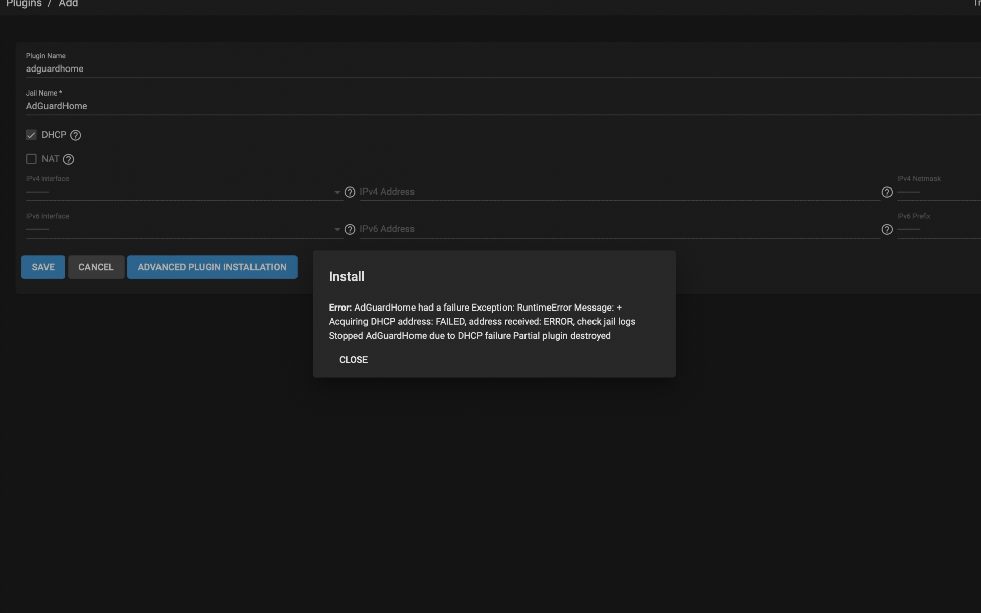

Usually, I try to avoid update jails.I had adguard installed earlier this week, but I was unable to upgrade the jail to the latest due to this error. I tried uninstalling and reinstalling, but have the same error. I am not using DHCP for the jail, as I'm manually assigning IP addresses for use with a reverse proxy. I tried installing another plugin and got the same error, so something is definitely up with the retrieval of packages or installation thereof.
I did try installing an IXSystems supported plugin and had no trouble. What other info would be helpful for troubleshooting. I'm a bit of a newbie in truenas, but I'm a software engineer, so hopefully I can get some good info for you. :)
I have NextCloud and a reverse proxy running in manually created jails, but it seems that I can't install any plugins period: ix or community. Nothing.Usually, I try to avoid update jails.
Did you already test the communication between the networks? you need to check it the truenas server can resolve names, from the network in use on your setup.
Furthermore, you can try to install a different jail/plugin using the NAT option. (please, do not use AdGuardHome in NAT mode)
Install Error: adguard.connectwithawalsh.com had a failure Exception: RuntimeError Message: pkg error: - adguardhome : Refusing to fetch artifact and run post_install.sh! Partial plugin destroyed
