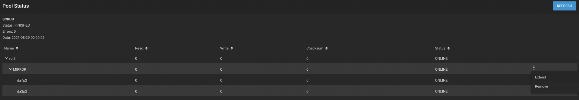

9,700
The only thing is that you can not do this from GUI and must turn to CLI for that.
Short answer, not possible
Not correct. It has been possible since TrueNAS, but wasn't in FreeNAS. I see the OP mentions TrueNAS, so...
It is possible under Pool Status from the 3 dots next to the mirror VDEV itself (Extend is the option you want)

extend extends the pool by another vdev. So you can add another mirror to the existing mirror giving you something like this:
That's correct, but (since the release of TN 12.0, at least) it isn't the only thing extend does--it also does exactly what @sretalla says it does, which is add a disk as a mirror. Or did you think he was just making it up?
Ahh... right... The ui is still confusing me :) Seems this is what I was searching for :) Yesterday I found an extend which does only add new vdev... But now I don't find it anymore :D
Well thats the solution
