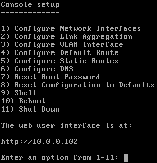

I had my new box up and running but I added a new 2 port Intel NIC and now I cant get networking up at all on any interfaces. I created a LAG for the NIC and I disabled the onboard NIC. Anyway now I can get any networking to work at all. Is there something I can do from Shell to like clear any Network Interfaces and get rebuild or something?

The console menu allows you to reset the configuration to factory defaults via option 8.

Unfortunately, yes. You can also try option 1 to try to redo your networking.

I did but it only gives me the Lagg interface that I tried to create. I tried to delete that in both option 1 and option 2. but it gives a weird message in option 2 IndexError List index out of range.
I mean I'm tempted to see if maybe I can just create another Lagg and see if that will work. I just need the interfaces to appear or something. If I enable the on board Nic and take the new ones out nothing works

OK, then try option 9 for the shell. Once in the shell, try ifconfig lagg0 destroy. Then exit to get back to the menu. Then you can set up your networking via option 1.
