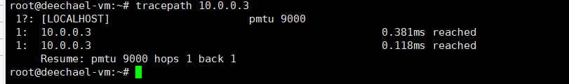

I configured MTU to 9000.

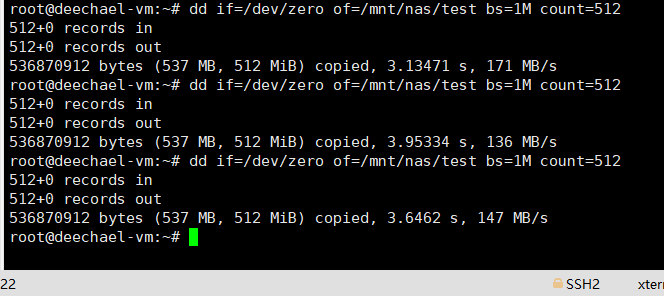

The question im facing is, the NFS speed is extremely slow compared to Samba.
I use this command to test speed:
dd if=/dev/zero of=/<pathToMyMountpoint> bs=1M count=512
And I just got ~150MB/s:

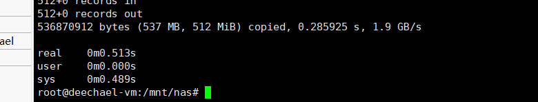

Compared to Samba:

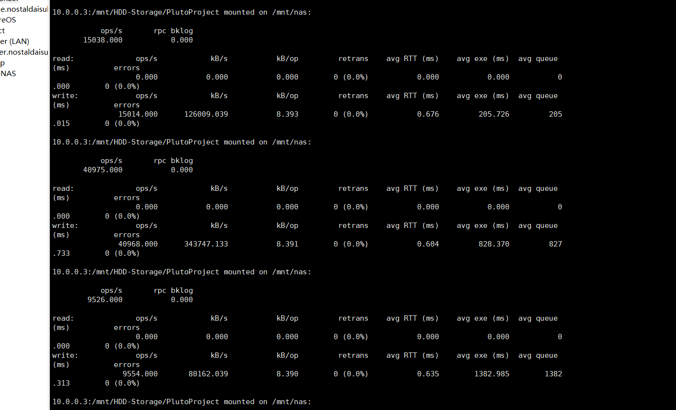

I found the exe time of NFS IO seems to be too long:
But i dont know how to fix this. :(

I let the rsize and wsize options to be default and disabled sync in TrueNAS Dataset, now the speed increased to ~1.2G/s.
Kailee71
Jul 8, 2018
110
Default options for NFS are usually safe and good these days. Same for MTU, the gains are usually neglible. I think the great big signpost in the sky in this case was the SMB transfers rate. Assuming you're on 10GbE your max throughput is under 1000MiB/s with an _extremely_ fast pool. You were seeing SMB writes being done async to storage, and the NFS write are being done sync (independently of your nfs mount!) as you correctly deduced. I personally will never take the risk with NFS data being async to storage (guarantees and requirements on the client are different between SMB and NFS), and for that reason I got a relatively fast SLOG vdev (RMS-200) which buffers the first 8GiB or so pretty fast. But that is a whole other rabbit hole to dive into.
