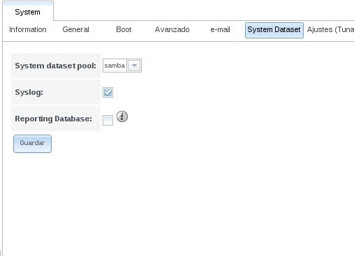

When I try to restart the service, shows me the following error:
# service syslogd restart
Will not 'restart' syslogd because syslogd_enable is NO.
#cat /etc/defaults/rc.conf|grep syslogd_enable
syslogd_enable="YES" # Run syslog daemon (or NO).
The system dataset is configured correctly. (see attached file.)
Thanks!!

I've having the exact same problem, even after reboot. The last message to write to the console in the webgui was:
Dec 16 00:00:00 rubbermaid newsyslog[19823]: logfile turned over due to size>100K
And I've gotten the same email last night at midnight and just now at midnight:
newsyslog: pid file doesn't exist: /var/run/syslog.pid
Not finding much with google. Reassuring this is also happening to someone else.
Edit: My system dataset (aside from pool name) matches the post above.
