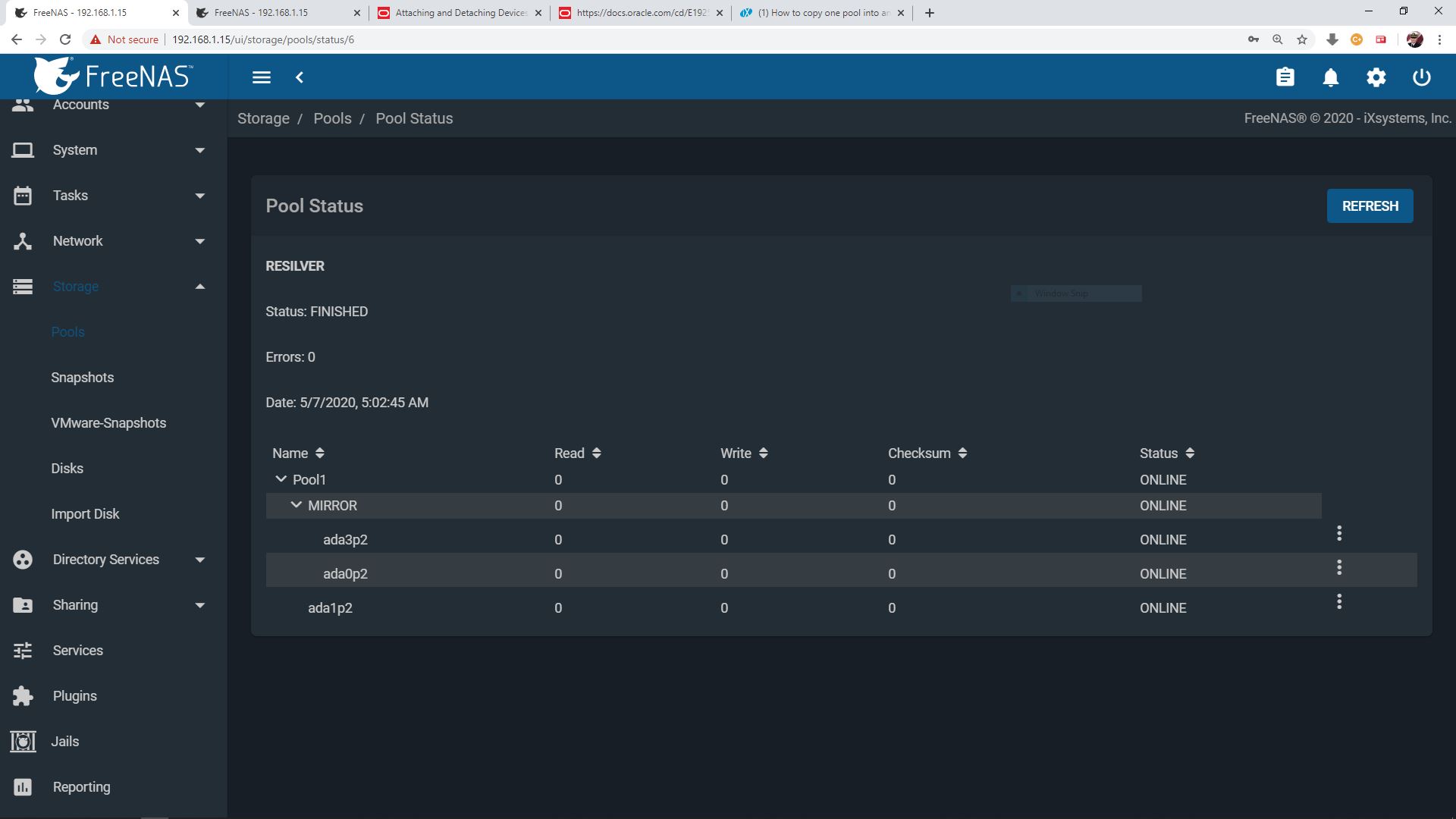

Thank you for the prompt answer! So, how do I fix below? I want to get back to two mirror VDEVS striped to regain the redundancy, but if I am seeing the below status correctly, I have 1 mirror VDEV striped to a single disk, and if I lose that single disk, I lose the entire pool. How do I attach a second drive to the single drive to make it a mirror VDEV again? Thank you!

Did you move cables around? Nothing wrong with that, it’ll work, just curious because: it looks like you are missing a disk. Can you see it under disks? Is it powered and cabled?

Assuming those don't hold data - which I don't know, you would - you should be able to "attach" one of them to unmirrored disk, creating a mirror. However, a caveat: I haven't done this, gptid's are to be considered, and you definitely do not want to "add", as that would just get you further down the road of a pool without redundancy.
zpool attach Pool1 gptid/currentdisk gptid/newdisk is how to attach, glabel status is how to find the gptid and match it to ada1p2.
Don't use the GUI CLI to make changes, use SSH. And, I'd think you'd want someone along in this thread who's actually done this.
How you lost that drive out of redundancy is a good question. Does zpool status also show a single disk for that second vdev?

Yes, zpool status shows a single disk for the second vdev. How do I find the gptid of one of the disks that are unused? That's what has kept me from attempting to use the attach command. I can't find the gptid for the unused disk.

YAY! The attach command worked! I found the gptid of the unused drive with the glabel list command. AWESOME!
