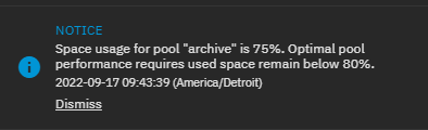

I have this notice in my alerts:
First, based on the text of this I do question why in the first place I am being notified that this look is at 75% with a recommendation that it be below 80% ? Isn't the recommendation already satisfied at 75%? I can "Dismiss" this alert.. but of course it still just sits there in a faded out state and my OCD gets the better of me and i want it just to be gone..... How do i actually get rid of this persistent notification?

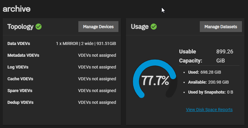

The actual pool is at 77.7% for what it's worth now anyways.

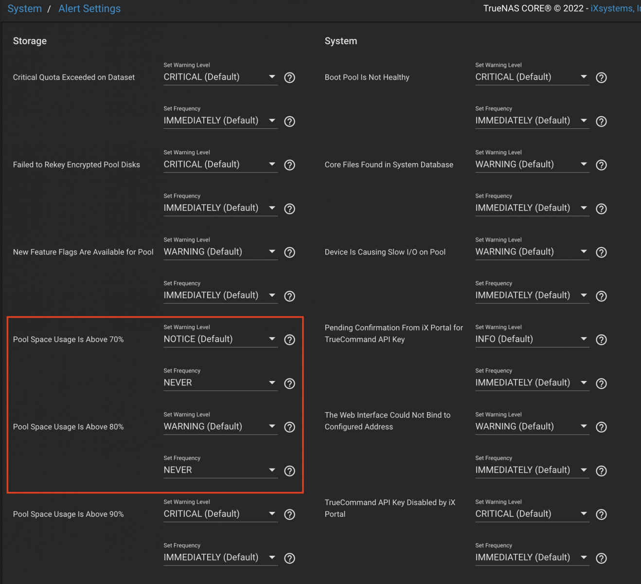

You can probably do it with this:
Don't forget to go to the bottom and save the change(s).
You may need to reboot the server to have it go away after that... haven't tested that part, but new alerts shouldn't come.

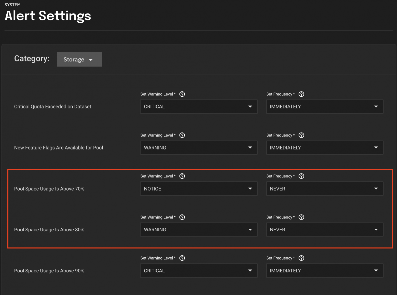

OK, So I noticed that you're on SCALE (posting in the general thread).
It's a bit harder to find in the menus...
Click on the alerts bell in the upper right, then on the cogwheel:
Then pick Alert Settings and select Storage as the category:
