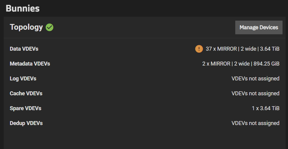

Sawtaytoes
Jul 9, 2022
221
1x 2-way vdev is a no brainer, but what about 48x 2-way vdevs?
Both drives failing in the same vdev would destroy the whole pool. Recovering from backups would be a pain.
How many mirrored vdevs would make you uncomfortable?
Dunno why I never posted this screenshot, but I guess I did post in January :p. This does make me uncomfortable, even with SSDs:
And I could and would add more vdevs, but at this point in time, I'm actually wanting to move to dRAID for more capacity (I have 120 SSDs in this system), and I'm still working that out right now or else this would be more like 48 mirror vdevs.
