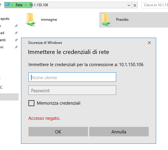

Was it a message like these ones?
BTW, what is the username you use in Windows?
Maybe you have set permissions on the share to the nobody user on FN, that is Everybody in Windows. If that is the case, you have to change the permissions so that only authorized users can access the share.

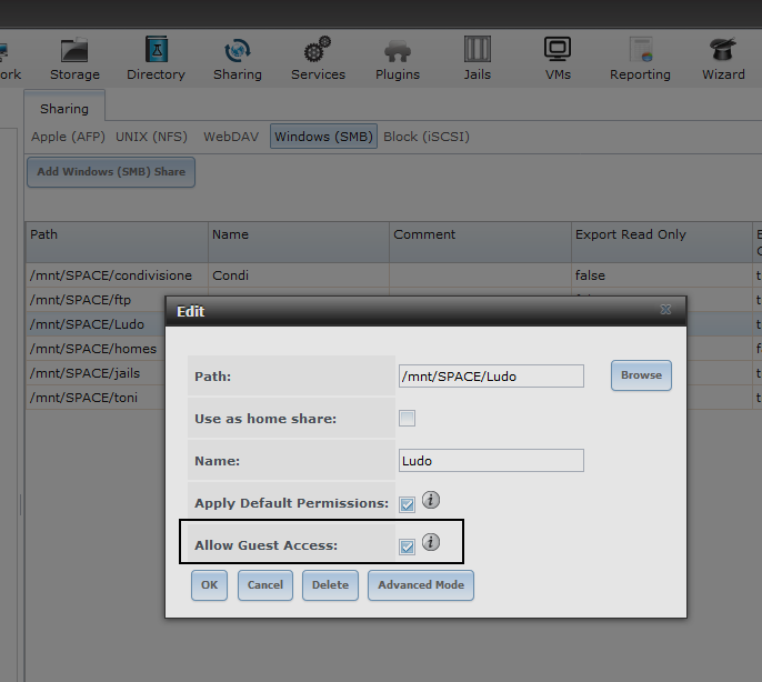

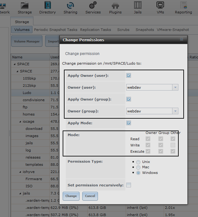

Look at the tab of the shares, Allow Guest Access and Storage -> Dataset permissions

Allow guest access isn't checked and the Owner (user) is set to "root" and the Owner (Group) is set to "wheel", so that may be my issue. How do I set the Owner (group) to "root" then or do I have to create a user that isn't root to do it?
