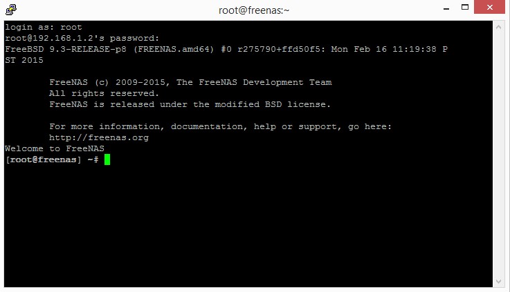

Okey dokey, so after a fair amount of tinkering about, I can now SSH into my Freenas box using Putty
I have literally no idea what to do next :D
Jailer
Not strong, but bad
Sep 12, 2014
4,977
It's easier to just copy out the file you need using an FTP client.
D
dlavigne
Guest
Try winscp, it has a nice double-pane graphical view where you can drag and drop files between systems.
Jailer
Not strong, but bad
Sep 12, 2014
4,977
Would you mind explaining how I would do that Jailer?
You've already got SSH turned on so all you need is an FTP client. Use the SFTP protocol and log in with your root credentials and browse to the directory where the file is located.
CraftyClown
Apr 5, 2014
214
Thanks dlavigne and Jailer
I have managed to grab the file I was after via Filezilla :)
One last question. When I SSH in to my Freenas box, it defaults to showing a folder called root, which only seems to contain the contents of the plugin jail I added the ssh commands to
I can still see all the other folders and files however, if I go up one level. Is this normal behaviour? and what would happen if I followed the same process with other jails? would their contents all end up in the same 'root' folder
I'm also wondering what the point of adding the new user was? (as suggested in the Freenas manual) as I needed to ssh in as root
