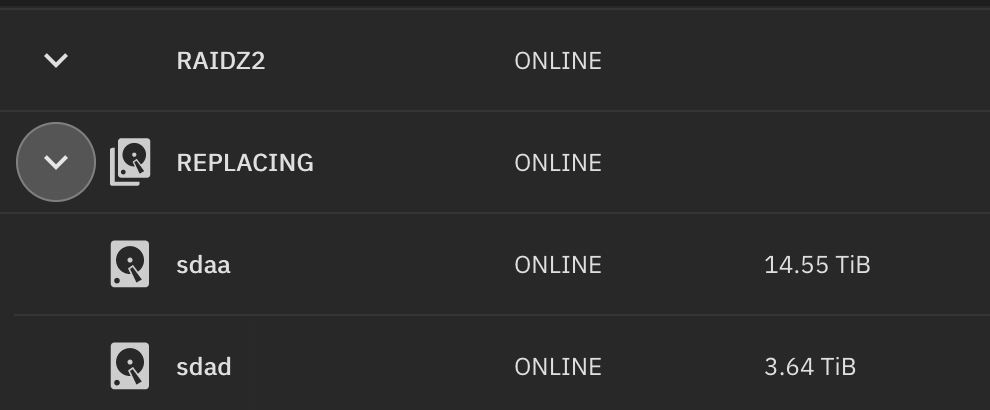

Weren't there issues with the WebUI when replacing drives from the shell?
At least while the replacement is pending, it looks like it's displaying correctly:

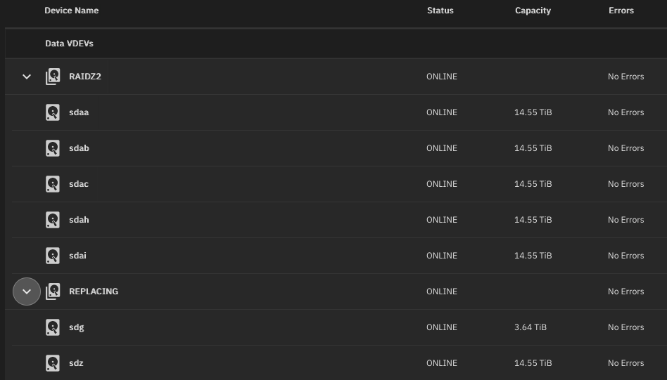

So it seems disk replacement can run concurrently, but only to an extent. I'd started all six disks replacing, but I started one of them several hours after the rest. This morning, the first five finished, and the last one appears to have just started based on the output of zpool status. Everything's still looking fine in the GUI, even having done the partitioning/replacement at the shell:
Davvo
Jul 12, 2022
3,222
Yes if I understand correctly there are tunables you can change in order to increase it.
That's weird, I remember stories of replacing entire 12-wide vdevs in one go.
15,504
I think it probably would have in this case too had I started them all at the same time within an appropriate margin--+/- several minutes would be within that margin; +/- several hours not so much. But that's just a guess at this point.
