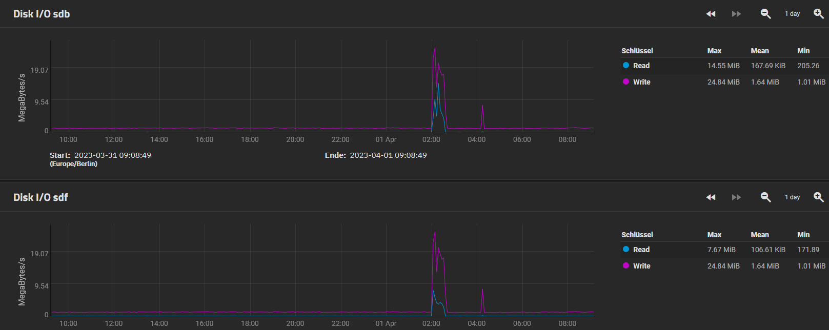

I don't know how you're "making" your backup... is it a snapshot? followed by a copy? to where? using what protocol/service?
The attached charts show that you're well under the expected maximum for throughput on those disks (although there's a lot of guesswork in that statement as you gave no hardware details at all).
I suspect you're somehow overloaded on IOPS (which is a little concerning as SSDs usually have a vast amount of IOPS capability compared to the requirement that a backup medium would have).
If you can explain a little better what's happening, maybe we can see where the problem is coming from.

why I don't see this muche I/O in the graphic? A ssd can writte 100+MB/s
The charts are showing throughput, not IOPS.
You can write tons of small files resulting in IOPS for each one or a small number of large files resulting in minimal IOPS, but a lot of data throughput.

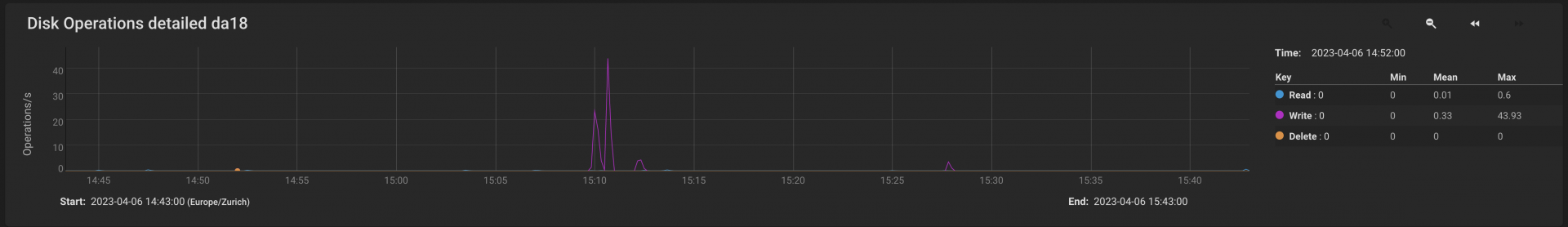

It seems reporting doesn't show IOPS in any of the chart options despite calling the throughput chart I/O (which means data in/out, not IOPS)
You can find those metrics in the reporting screen for CORE though:
And you have it on SCALE for NFS (if you were sharing out your ZVOL over NFS).
