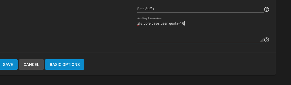

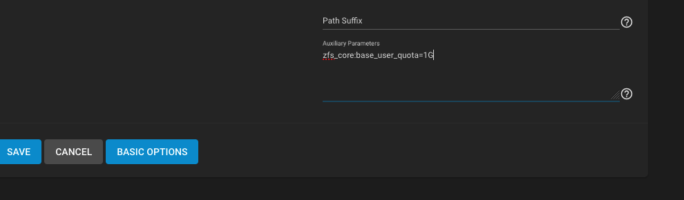

Thank you!! Will give it a try
To confirm, this would be within the auxiliary parameters, as shown below?
