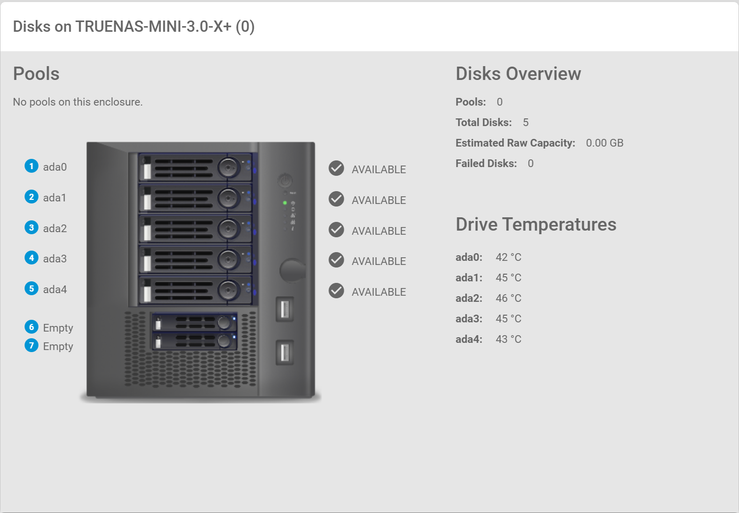

I recently purchased a TrueNAS Mini X+ and have filled the five 3.5" bays with 14TB WD Red Plus drives. I am seeing fairly high temps while the disks are at idle, as can be seen in the attached screenshot. After an hour of idle, the disks are averaging 42C-46C, in a 21C room. This seems very high. So high that I have not tried stress-testing the disks yet. I have since shut the system down and will not be running it until the idle temps can be better controlled.
I have noticed that the "FANA" is always spinning at 600 rpm and never seems to speed up. Is there a way to better control this through ipmitool? (Output included below). Various forum posts here have not provided a solution. If I wet a finger and stick it behind the fan, I can feel very minimal air flow. The fan is spinning and is not making any odd noises that would indicate bad bearings.

Does anyone have any suggestions for why "FANA" might be stuck at 600 rpm? Any help is greatly appreciated.

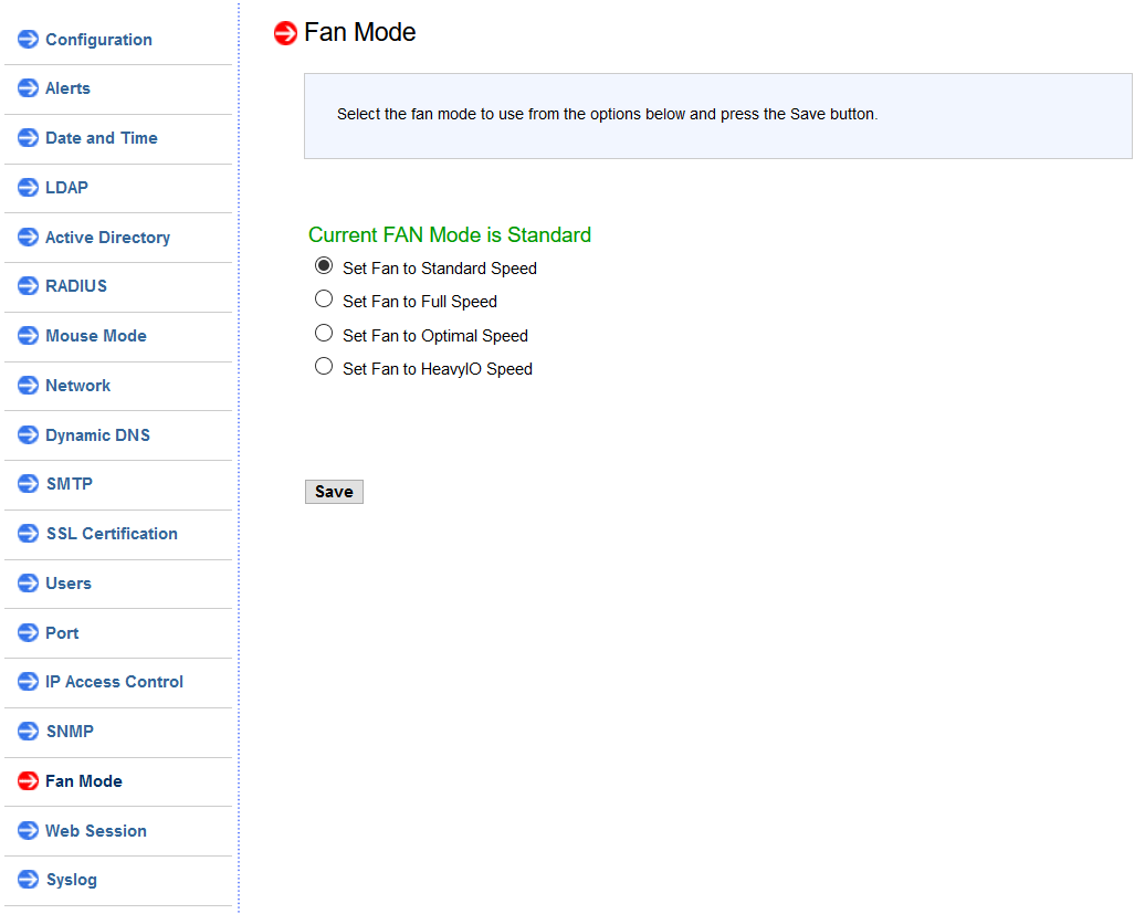

Can you post a screenshot of your ipmi web interface the tab under Configuration(top bar) -> Fan Mode.
If your currently set to optimal I would try first standard (Move baseline from 30% pwm to 50% pwm) and then after that if you still need more speed you can go to heavy/io which will move rear fan to ~70% pwm min and main fan to ~50% pwm.
Finally there's full but that will probably be to loud setting both cpu and rear fan to 100%.

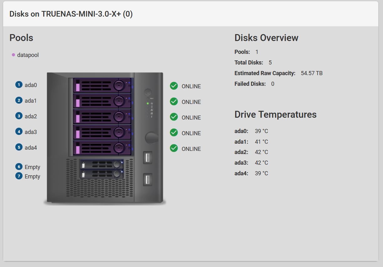

Hello Ben,
I have a TrueNAS Mini X+ too and have filled the five 3.5" bays with 12TB WD HGST He12 drives and the TrueNAS Mini X+ is standing in a room that has an air temperature of 20C-21C.
I use the 12.0-RELEASE software "out of the box" without any optimizations of temperature, power-consumption or fan speed.
Here are my temperatures and fan speeds for comparison when the disks are idle (no data transfer, scrubbing, etc.) for several hours:

My FANA is also at 600rpm, but my FAN3 is running slightly higher than yours at 3900 rpm. When I stick a finger behind the Mini/fan I can barely feel the air flow.
The disk in the middle, ada2, was and is the hottest of my drives and it reached 50C under heavy load in the first days but runs now always below 45C even under load.
Maybe your WD 14 TB drives just produce more heat and how tight the disc enclosure is build results in slightly warmer drives and the fan speeds need to be increased for drives that generate more heat?
I do not know how to increase the fan speeds more when the drives run hotter, but maybe this comparison still helps somehow.

I am not sure if the fan speed can be changed in the bios of the TRUENAS-MINI-3.0-X+. I rebooted the machine and went into the bios via IPMI but did not found a fan speed setting in the bios.
However, during my search I noticed, there is a fan mode setting in the IPMI interface itself, so the fan speed setting can be changed without reboot. I should have taken a closer look into the IPMI interface earlier. :)
I changed the fan mode from "Standard" to "Optimal", because "optimal" sounds optimal :) but I really don't know what exactely the difference is.
I can guess what "Full Speed" means, but is there some info/documentation about the differences between "Standard", "Optimal" and "Heavy IO" ?

You need to get hold of a copy of the motherboard manual for your box. I don't know whose/what motherboard it is but a look under the hood should find that, then go to mfr site and get it - also the ipmi manual, too. If it's a SuperMicro board, both will be available I imagine.
Thanks.
The TRUENAS-MINI-3.0-X+ has a Supermicro A2SDi-H-TF Board. The motherboard manual says nothing about the fan mode, but the IPMI says:
  • [Standard Speed]: to use the standard fan speed setting for power savings.
  • [Full Speed]: to use the full speed setting for optimal system performance.
  • [Optimal Speed]: to use the optimal fan speed setting, which will adjust the fan speed by balancing the needs between system performance and power savings.
  • [HeavyIO Speed]: to use the heavy I/O speed setting, which will boost cooling to the add-on card zone.
The change from "Standard" to "Optimal" did not change any idle disk temperature. Then later I changed the setting from "Optimal Speed" to "Full Speed" and the idle disk temperatures dropped below 34C within one hour (and stayed there even with a little bit of disk load).
It seems setting the fan mode is more like an on / off switch and there is no way to fine-tune the fan control.
