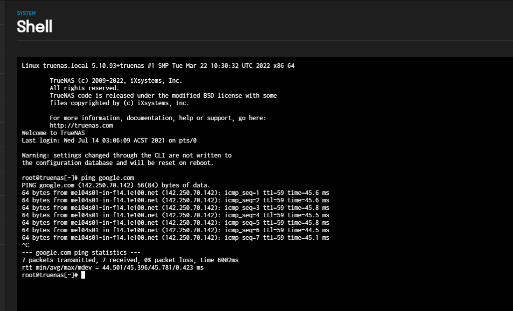

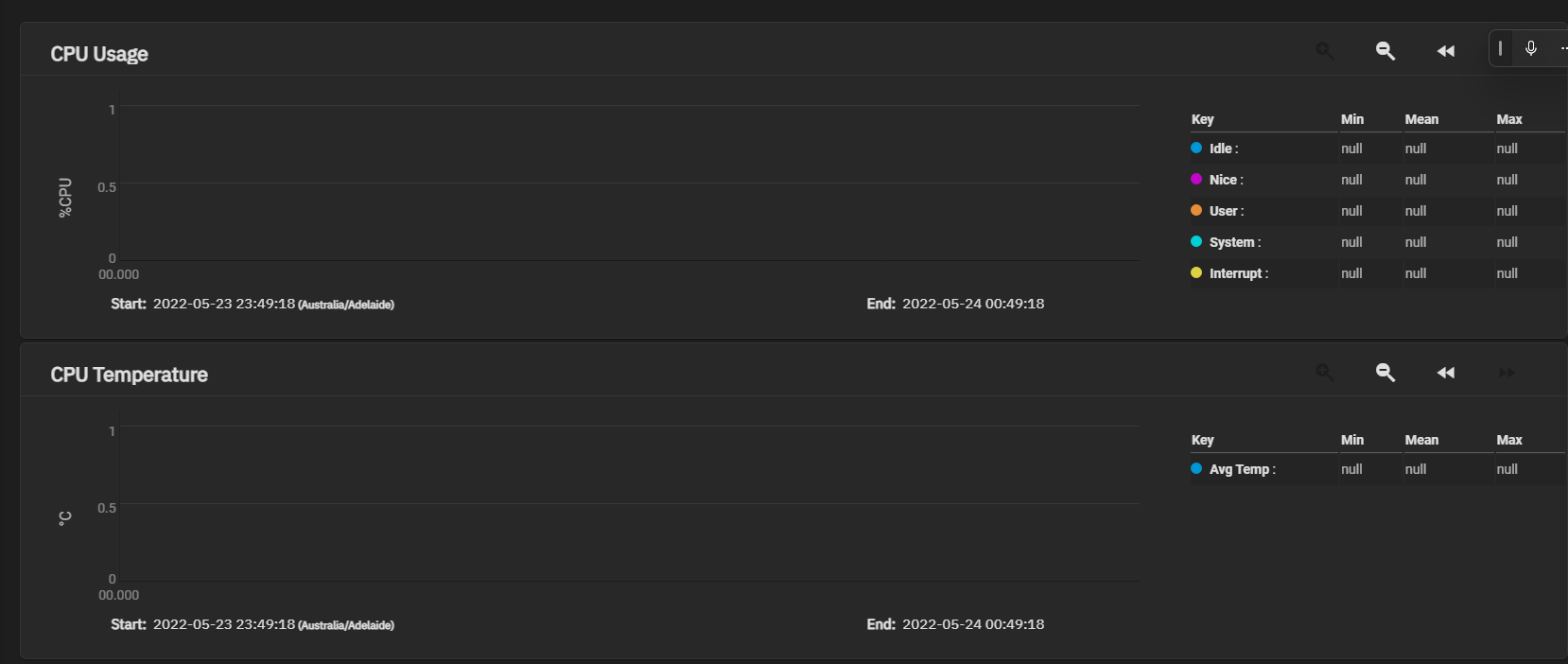

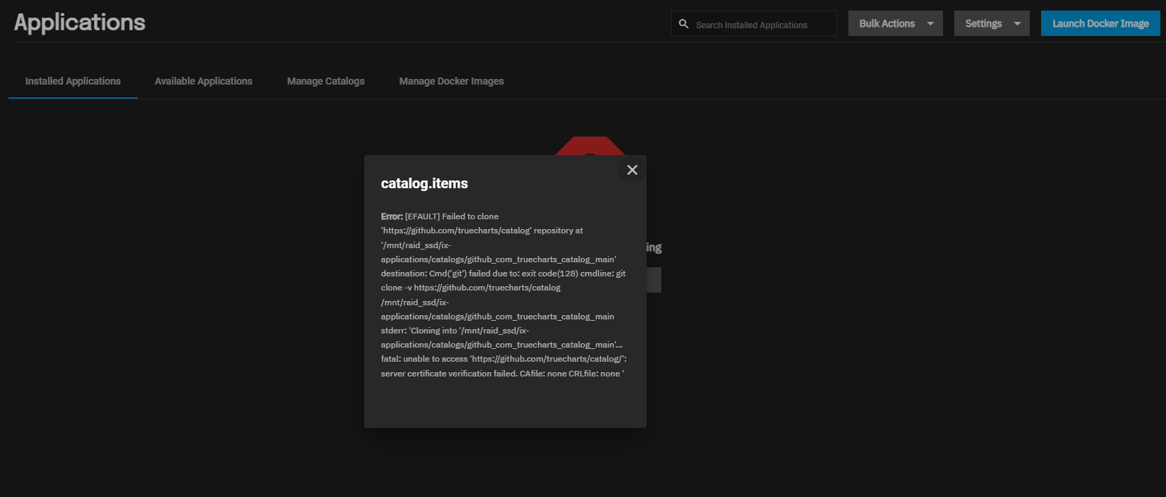

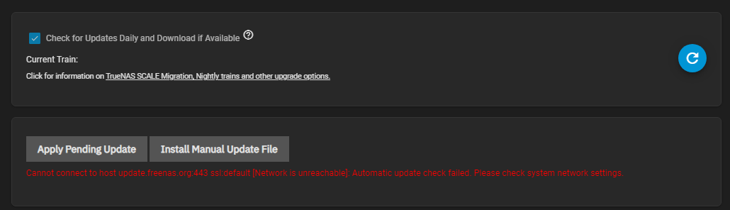

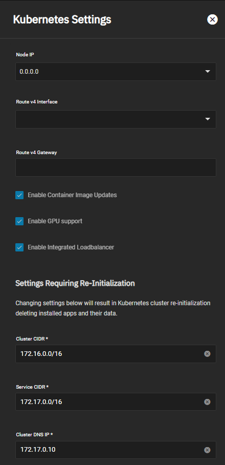

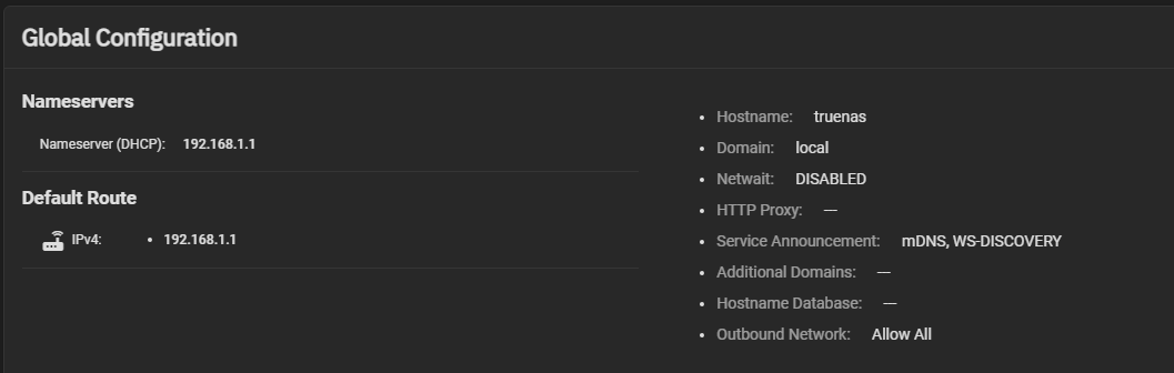

Hey so I'm not entirely sure what happened. I woke up in the morning and had all of my contacts flooded with people spamming me about how the server is down. Now the box is safely stored and it was offline. I boot the server back up and it cant do any of the basic functions it needs; such as syncing catalogues; showing the the reporting section (its just blank) or checking for updates. Now I can assure its connected properly and has internet as I'm able to ping external sites with the shell. If i could get some help that would be greatly apricated.
9,700

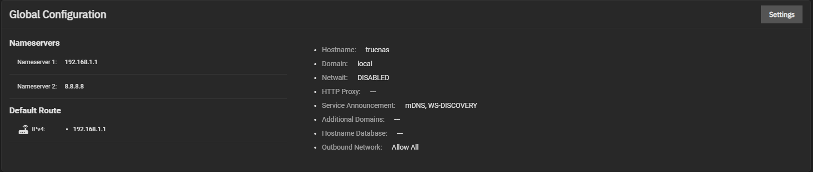

So what does it say on your Network | Global Configuration page?
And also on the Apps | Advanced settings (from the settings menu button in the first screenshot)
9,700
OK, well we should start by filling in those 3 first settings...
You can leave the IP as 0.0.0.0 if you don't care about using any interface in particular. Or specify the TrueNAS address you want to use if you have more than one and only want one to be used.
Pick an interface that's the way out of the server for your containers.
Specify your router (192.168.1.1)

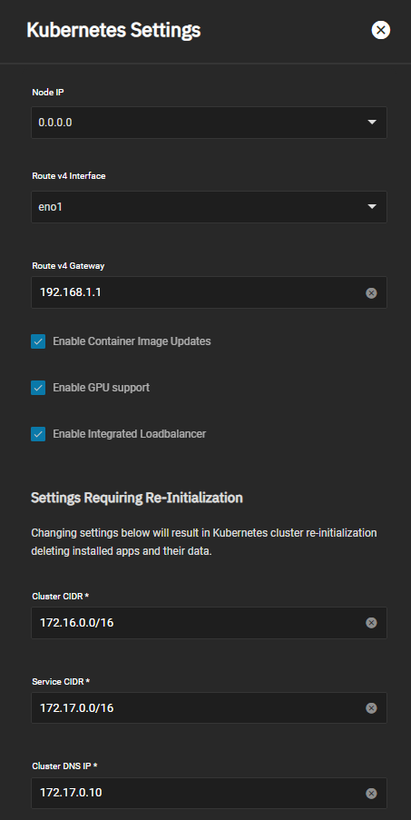

I did that and still have the same issue; heres the updated settings

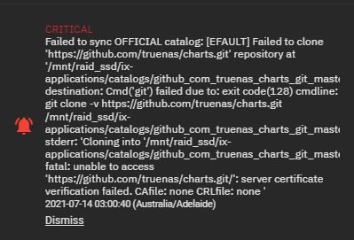

I think the problem might be with something to do with the default server cert? if you see the last line its saying cert verification failed.
9,700
There is likely to be something to that as you say... not sure why as it shouldn't really show that error unless it was able to complete a DNS lookup, which is where it seemed to be failing before... and if that cert is really the problem, then everyone should have the same problem.

Not sure how it would be failing a dns lookup but still able to lookup other services and sites like google for the ping though? But even still i added backup nameservers just incase that was the issue (I'm sure you noticed in the picture) and its still broken.

Can you change the date and time in the UI or failing that in the BIOS?
The error message mentions 2021-07-14; if the date/time is that far behind it is going to fail any secure handshake it tries.
