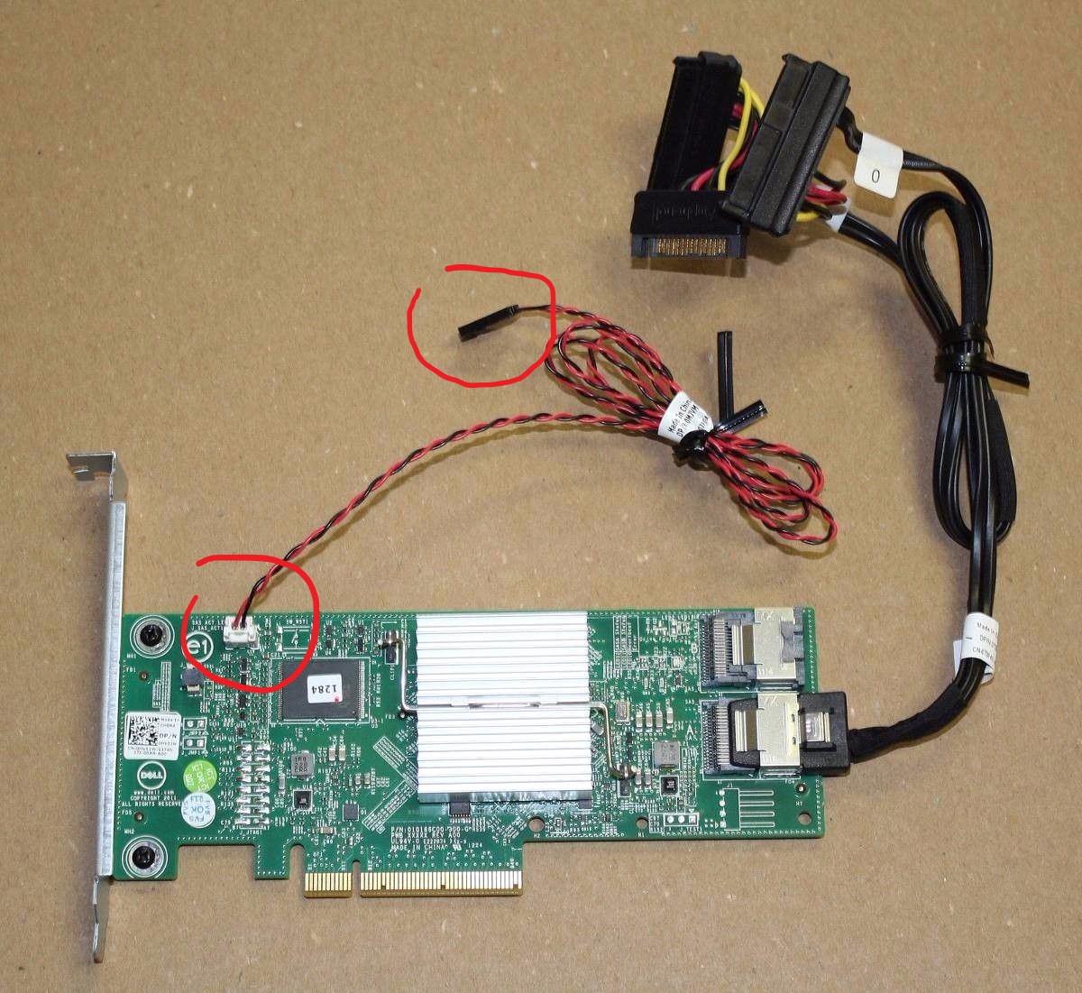

See where I circled the two ends of the wire in red. You need a wire like that, which is designed to plug into the header on the card and the other end plugs to a header on the system board. But the system board must support the input. I will take a look at the manual for your system board and see if I can find out if it will do it.
I just checked the X11SSL-CF quick reference guide and the board only seems to have the one drive activity header. The SAS3008 has a dedicated on-board status LED, but no headers.

Motherboard: Supermicro X11SSL-CF (MicroATX LGA1151)
The model you pointed me at has a built in SAS controller. There is still a separate header on the system board for the SAS activity LED. It is labeled LEDS1. You may be able to simply connect the HDD LED to that header instead of connecting to the SATA HDD header.
You posted while I was posting. I should have waited. You are right, now that I look more closely, it isn't a header. My mistake.
Yeah, I definitely strongly advise against trying to solder onto the pins of that LED to make an improvised header.

Thanks for looking guys! The case I have has a window so I do see LEDS1, but it's just blinking green. Looking at the quick reference guide, it says that it blinks green when "SAS active" and is solid red when "SAS Error", so it's not a HDD activity LED. Unfortunately, it looks like none of the other LEDs are what I want. Oh well!
