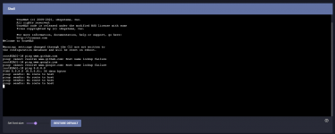

-After reading online threads I figure out it's a network-related issue
-Tested my Ping in the shell and sure enough, I get "ping: cannot resolve www.github.com: Host name lookup failure
-Then I get stuck not quite understanding what they mean when talking about all sorts of subnets and IP addresses

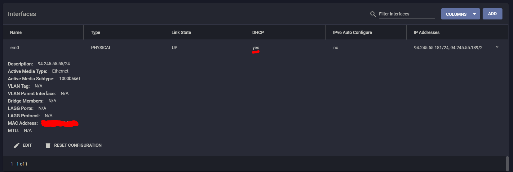

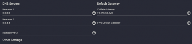

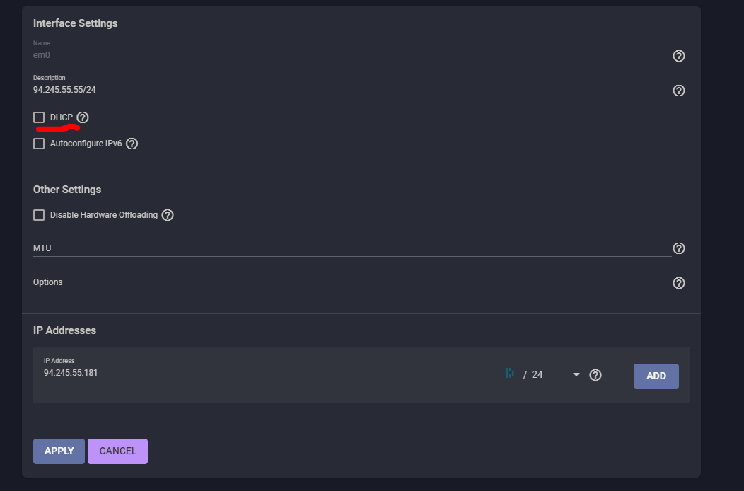

Have you set a static IP address in Network > Interfaces?

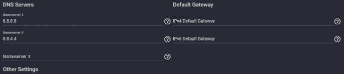

If yes, you also need to go to Network > Global Settings and configure your DNS server and default gateway.
Izanagi
Nov 14, 2021
6
So as far as I remember when you say "static IP address" you mean turning off DHCP? if so then yep and as for the DNS server and default gateway that is the part that confuses me... I have set it up as shown in the pictures with DNS being 8.8.8.8 and 8.8.4.4

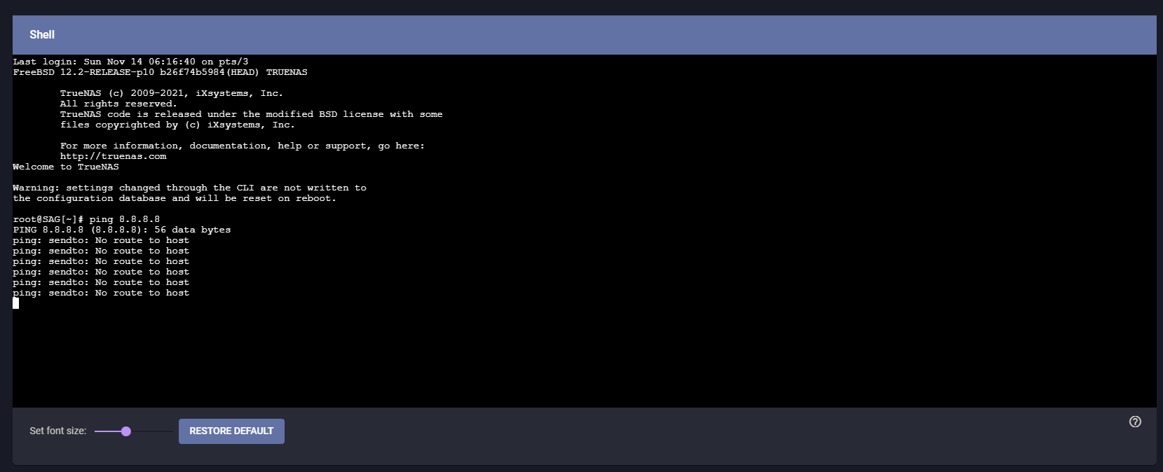

Can you ping the default gateway from the TrueNAS? Can you ping 8.8.8.8 from the TrueNAS? Are you sure you want to connect your NAS to the public Internet? At least your IP addresses look like you do ...
Izanagi
Nov 14, 2021
6
Nope I can't seem to ping 8.8.8.8 either hmmm... Also I pretty much just need to get some plugins installed like plex and unless I'm misunderstanding something you need to connect to a public net todo so.

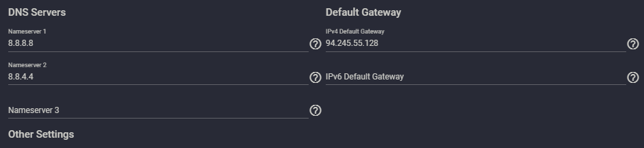

Your default gateway seems to be incorrect. Who gave you the network parameters?
You could set your network to DHCP and check what that results in.
As for the plugins, yes, you need Internet connectivity. But the NAS should be located behind a router or firewall, not on publically reachable address space. At least for IPv4 that means RFC 1918 addresses 99% of the time.
Izanagi
Nov 14, 2021
6
Ok, I gave that a shot trying DHCP with just default gateway set IPv4 set anddd no luck either i got the IP from trying another help thread on here anyway still can't ping any websites or 8.8.8.8 At the moment both my home PC and NAS are plugged into my modem is that a problem or?

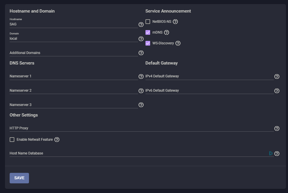

Don't set the gateway or the nameserver when using DHCP ... you will get all of these from your DHCP server. Then you can note them down for manual configuration.
Izanagi
Nov 14, 2021
6
Alright pretty much restored it to default DHCP set to yes and a blank IPv4... Tried to ping a website and 8.8.8.8 no luck then I did a full reboot and still nada... Hmmm unless you see something wrong here
