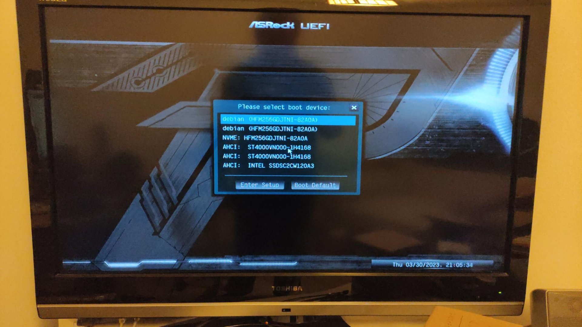

Without my interaction, my TrueNas-Scale installation (22.12 Bluefin Release) did a shutdown and is not able to boot since than.

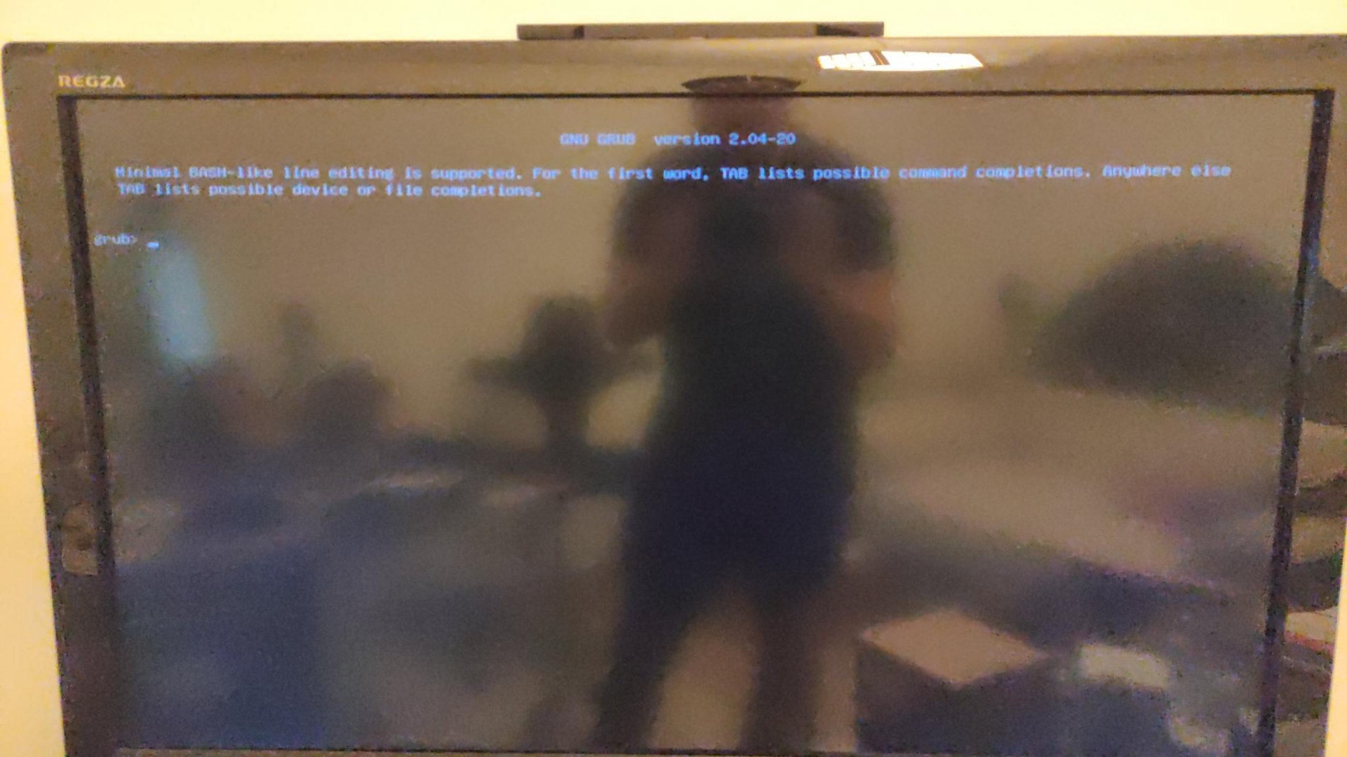

Following a screenshot from the boot state. Grub is there but does not know how to continue.
From the boot entries itself, it is still there. I am able to select the nvme drive with the two expected (two expected, right?) boot entries

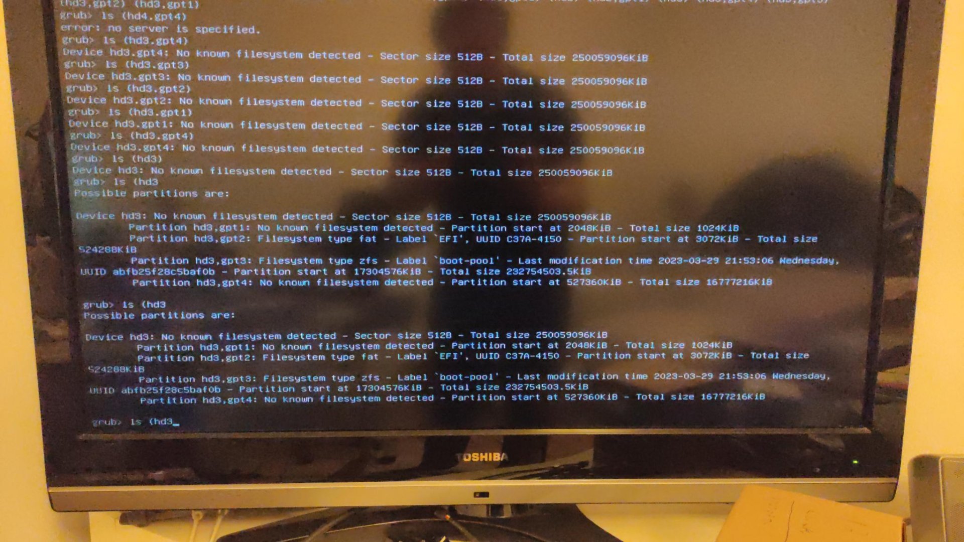

My problem is, that I did not find any documentation how to fix this grub installation. There are a lot of default grub error fixing how to's like [this](https://christitus.com/grub-rescue/) one. But as you see, by hd3 has a efi labeled partition and that's it.

My problem is, that neither `set root=...` nor `set prefix ..` is resulting in a working `insmod normal` or in a boot. I am stucked at this point and again, can not find anything in the official [documentation](https://www.truenas.com/docs/scale/gettingstarted/)
