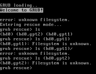

Today I started my FreeNAS 9.10 to do a BitTorrent Sync backup update over the Internet (NAS is at another location). As usual I checked if there was any updates to my FreeNAS 9.10 stable train already installed. As usual there was a newer build so I did the update which downloaded, installed & rebooted. WebUI never came back again so via IPMI I checked the boot screen which showed the following (I entered the ls commands later).
The USB is a 8GB stick plugged into the internal USB connection on the motherboard. There was plenty of room on the stick, only a third of the space was used.
Is the USB stick completely buggered? If so it's the 2nd to bite the dust :-(

What brand/model of USB stick was it?

It's likely toast. Buy 2 when you replace it so you can mirror them.

I agree, probably toast.
For replacements, now might be a good time to jump off the USB ship, and get a small SSD for your boot device. You can get 30GB or smaller SSDs for crazy cheap, so if you've got space in your case/controller, it's worth considering.
