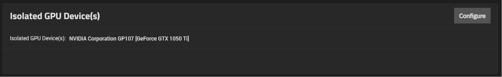

I have isolated the GPU in the settings

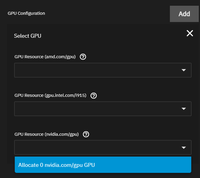

I dont se any options to pick for GPU passthrough:

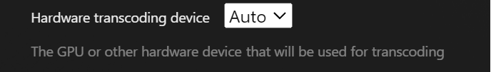

That means I dont see any devices in the Plex transcoding settings as well (dropdown only says Auto)
I have never required transcoding but recently users are buffering and at times getting the "This server is not strong enough" type plex nag.

if need to assign GPU to apps, supposedly you don't need to isolate it in config, that's for VM assignment i guess.
But even with correct setting, I still have the same issue not getting GPU working in apps, no process detected, previously they said it's an issue with iommu in 23.10.0.1, but after upgrading to the latest, still the same.

Disable the GPU isolation as it's no needed.

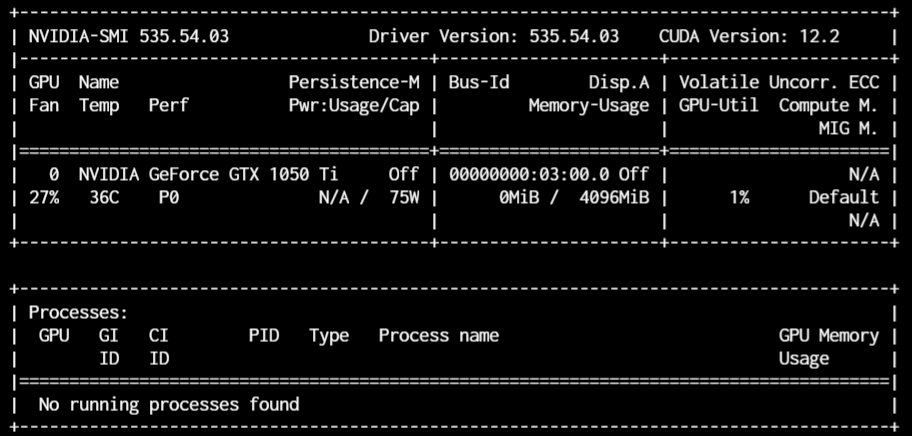

I can confirm that I don't isolate GPU and it's also enabled in app's k8s settings. The plugin is running from cli checking, since my nvidia 1060 has been recognized by the driver (shown in nvidia-smi) and I'm also able to assgin GPU to each app, but no any process shown to use the GPU, that's why I'm totally lost where to look at the issue.
root@truenas[~]# k3s kubectl get pods -A | grep nvidia
kube-system nvidia-device-plugin-daemonset-857x2 1/1 Running 0 3d20h

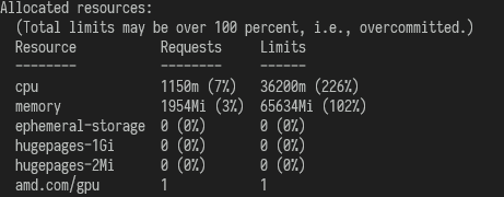

In this case the node should have been labeled by the device plugin, can you try and run a "k3s kubectl describe node ix-truenas | grep gpu" and check the "Labels", "Capacity" and the "Allocatable" section.
Also, at the end of the "describe" output, check the "Allocated resources" section, if the GPU is already allocated it may not be shared to another app again.
Here's how it looks for me with an AMD GPU.
