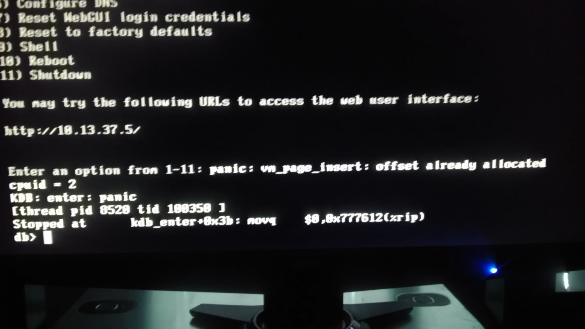

Hi everybody!
I've had this issue transferring files from my desktop to a new freenas build. The build consists of the following:
AMD x3 720
16gigs of DDR3 1600
8x 2TB WD Red Drives
Freenas FreeNAS-8.3.0-RELEASE-p1-x64 (r12825)
It's happened 3 times so far when I try to copy large files *700gigs*, the freenas rig will freeze up about 1/3 of the way through and wont let me reset it or log back in through the web interface. I have to do a hardware reset and it is starting to concern me as far as if this rig is stable or not.
I took a picture of the monitor of the Freenas with the error and any help with trying to figure out what's going on would be most appreciated! :-D

You should be concerned.
Do you do scrubs regularly? Have you tried a RAM test? Is your hardware overheating?

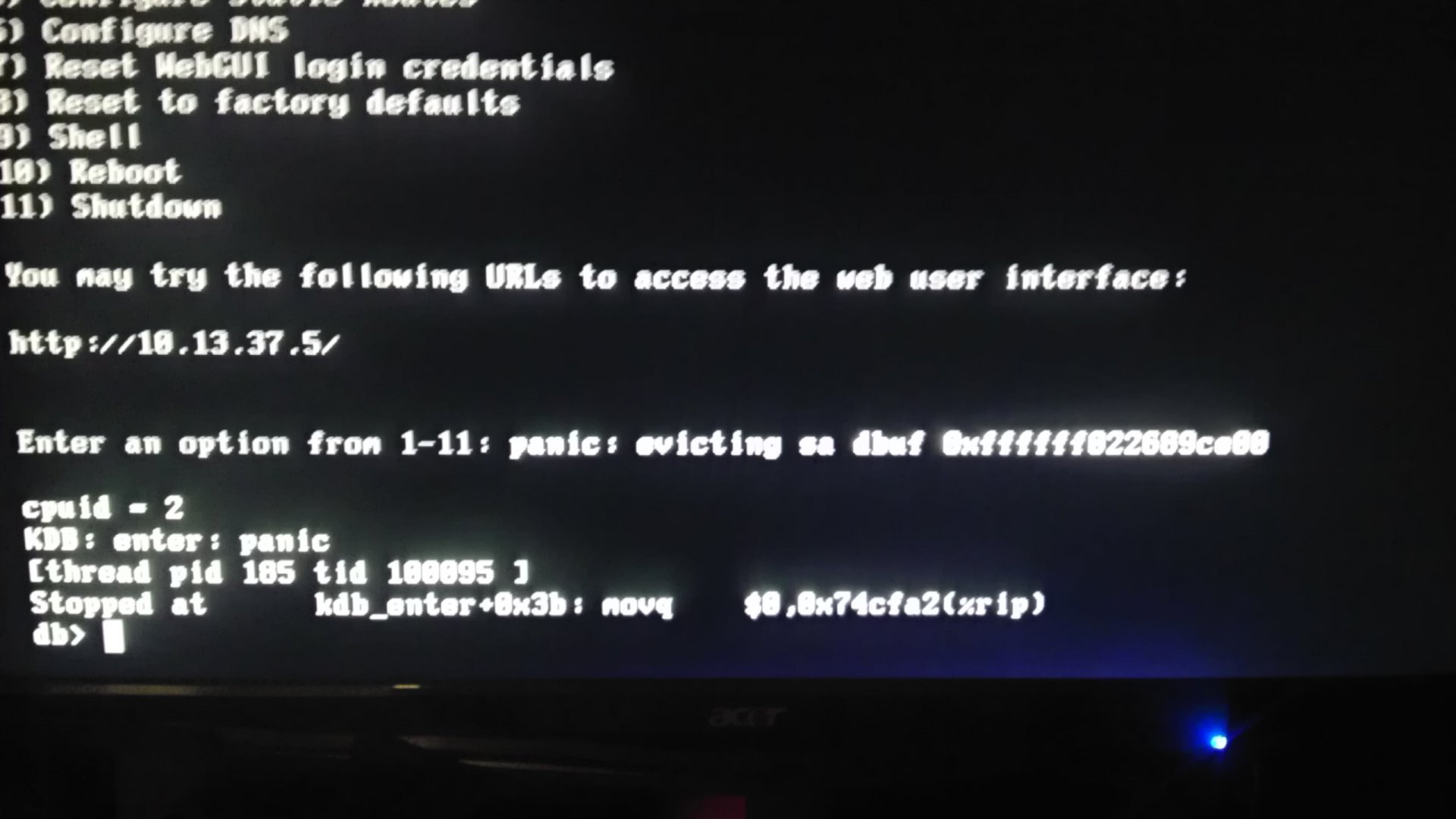

I have just gotten another error which is different that the one above...

You ran 3 full passes on your RAM in that short time? Normally I start a RAM test and go to bed...
Are you using dedup or compression on the zpool?
Any reason you aren't using 8.3.1-p2?
Edit: Are you using encryption?
Djdiddles
Aug 25, 2012
9
well I took it out of the freenas rig and hooked it in a benchmarking rig. I have ram coming out my wazoo so I just popped in a different set of 16gigs and started up again. I only did one pass on the memory but all came up clean.
I'm not using dedup or compression on it zpool and I went ahead and updated the firmware to 8.3.1-p2 just for good measure. Also, I'm not using encryption.
What I did was take out one of the cheap pci-e sata cards. Since it was just a sata card and not a raid card, I figured it would be ok to use. I took that out, and things started to became stable. I wanted to avoid having to use a raid card. I guess IBM M1015 here I come...
