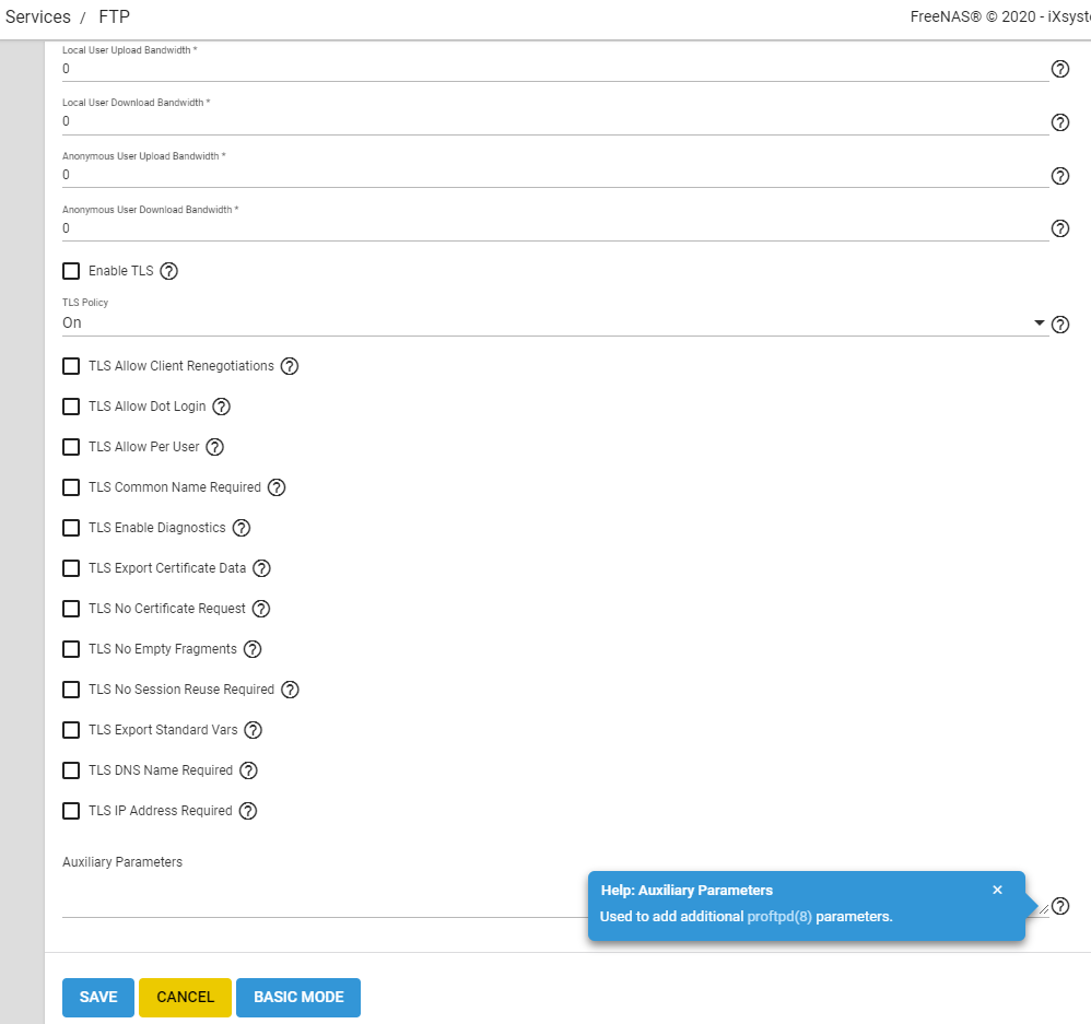

FreeNAS protects the proftpd.conf, so any edits to it via nano are overwritten from the master copy in the FreeNAS database. To have your changes stick, add your additional configuration to the Auxiliary parameters field in the FTP service UI:
This will inject your changes properly into the master copy in the database.

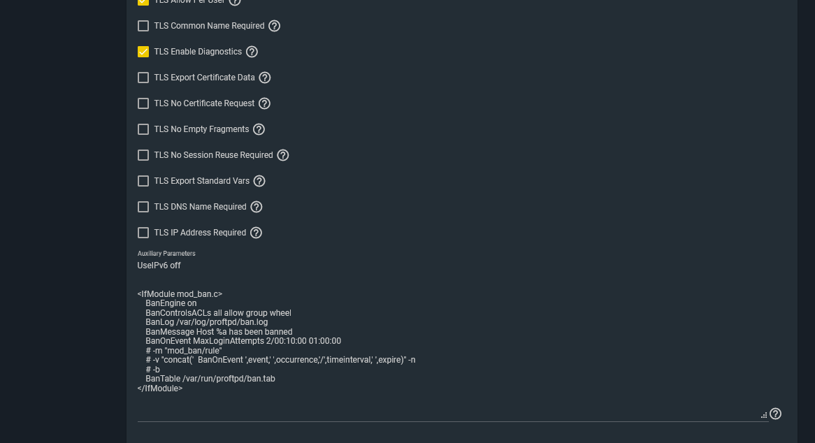

hi.
config file active modules do not change when i do this.
sample add parameters
UseIPv6 off
<IfModule mod_ban.c>
BanEngine on
BanControlsACLs all allow group wheel
BanLog /var/log/proftpd/ban.log
BanMessage Host %a has been banned
BanOnEvent MaxLoginAttempts 2/00:10:00 01:00:00
# -m "mod_ban/rule"
# -v "concat(' BanOnEvent ',event,' ',occurrence,'/',timeinterval,' ',expire)" -n
# -b
BanTable /var/run/proftpd/ban.tab
</IfModule>
